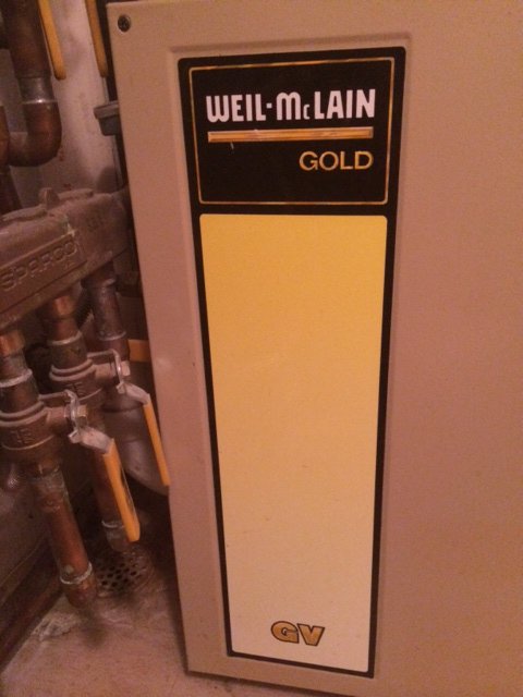

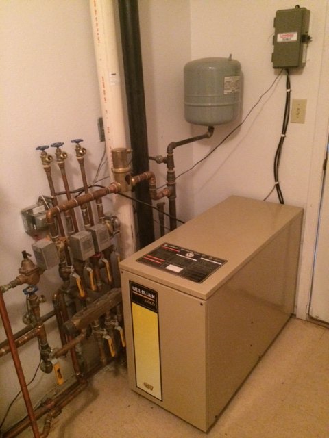

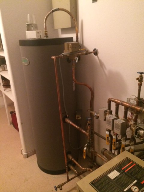

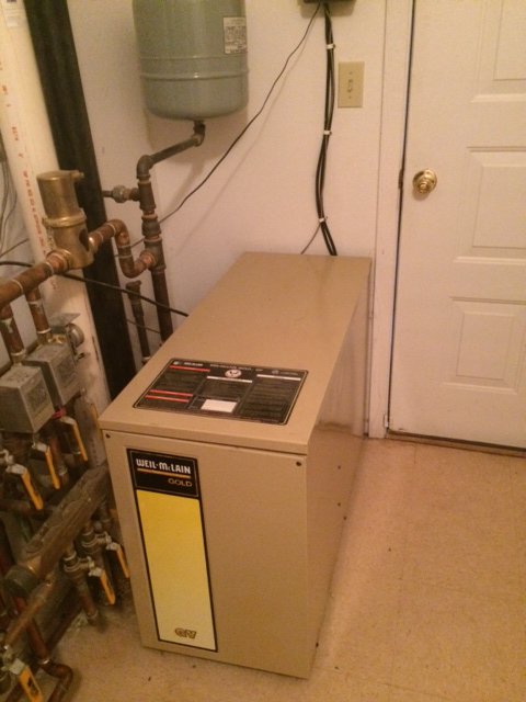

    Late but as promised, some pictures
    From the Left:
    1. Manufacturer's Big Sticker on the front of the Boiler
    2. The Boiler Box
    3. Boiler and most of Associated Plumbing
    4. Looking the opposite direction from Photo #3, the remainder of the plumbing and the indirect Hot Water Tank
