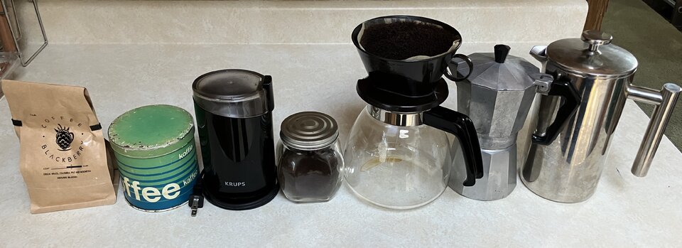

    Maybe break the process into different components. Our process:
