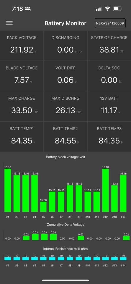

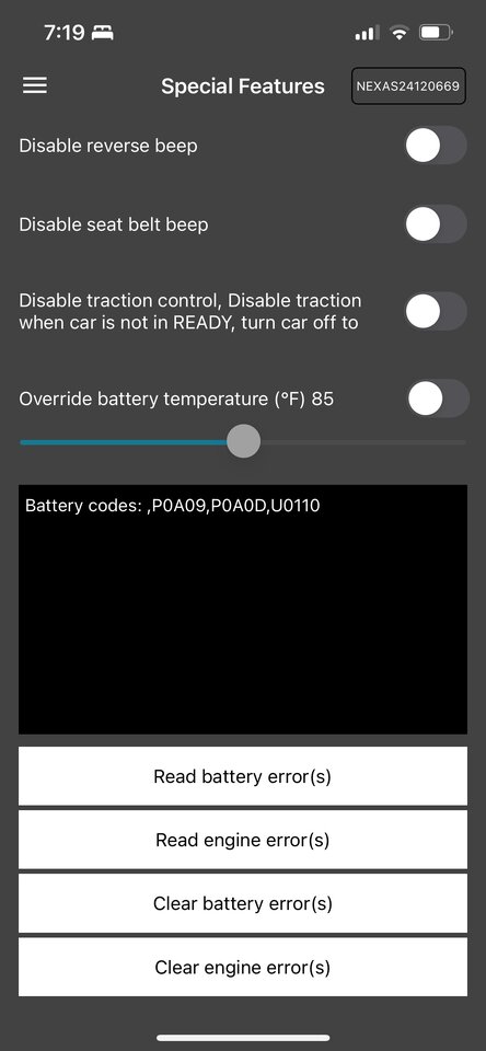

    Update: That Nexas Link arrived 10 minutes ago. Curious, I when and loaded up the Dr Prius app, and checked.
    Battery codes it reported was P0A09, P0A0D, U0110.

    Codes from the Dr. Prius app.

    Check the service plug, remove and reinstall it.
    Check all the connections, again, even ones your think you didn't disconnect.
    Was everything working before hand? I can't remember.
    It's either the service plug not installed correctly, or a loose or bad connector.

    The safety interlock circuit that P0A0D refers to includes the pair of small contacts on the orange service plug (the ones that only mate when the handle is slid sideways in the last step) and also includes contacts beneath some of the inverter covers. If any of those covers were off, double-check those too. There are some good threads here about P0A0D troubleshooting.
