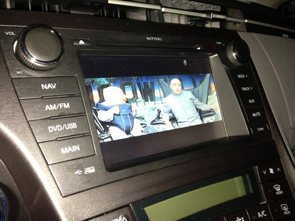

    My M&D in DVD mode. The movie is widescreen format.
