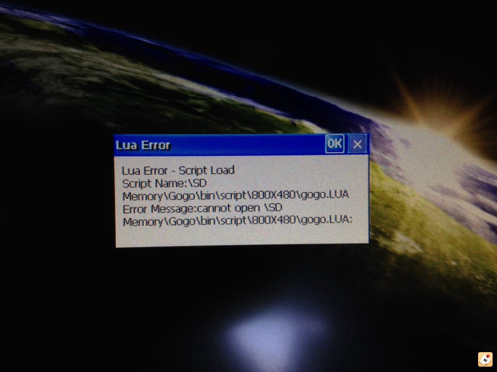

  19. TheredBull
    TheredBull Junior Member
    May 23, 2013
    30
    Southern California
    My Navigation stopped working yesterday. This was the [​IMG]message on screen. Unfortunately, I did not make a backup. Please advise. Thank you.
  20. SoCalBPrius
    SoCalBPrius Active Member
    Jan 8, 2012
    563
    118
    SoCal
    Yep, I get a similar error code. I couldn't get mine to work either. It's been down for over 3 weeks now:eek:.
