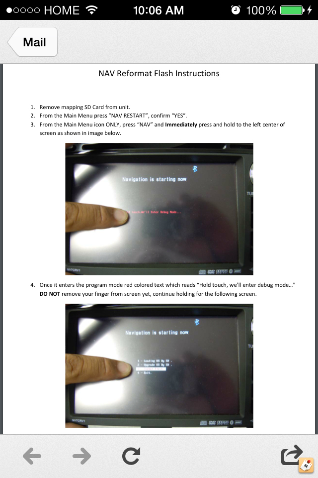

  3. TheredBull
    TheredBull Junior Member
    May 23, 2013
    30
    Southern California

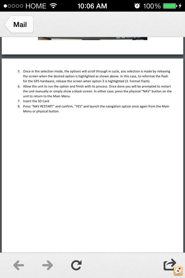

    I contacted m&d. They sent me the instruction below to try it first. If I does not work, I need to call warranty dept. I will give it a try this evening. [​IMG][​IMG]

  9. TheredBull
    May 23, 2013
    30
    Southern California
    I tried and it did not work. I called and talked to tech supports again. They said SD card was the cause of navi error. I need to send in the SD card. They will charge me 35 dollars to diagnose the files in SD card ( wow). I will never buy any device from m&d again. :(.
