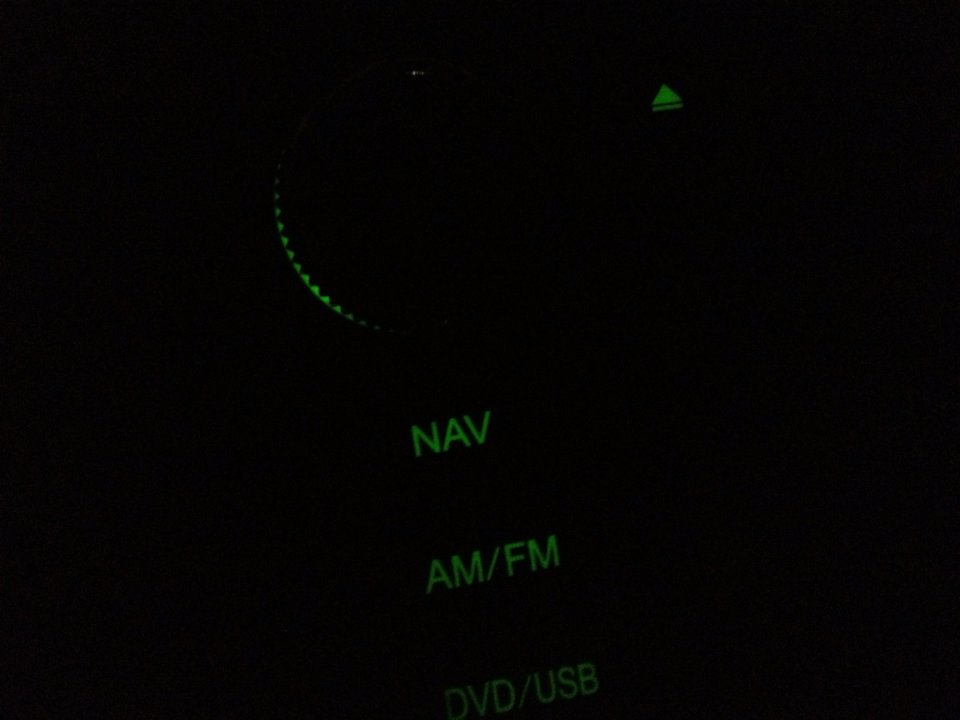

    OK, the buttons light up green at night.

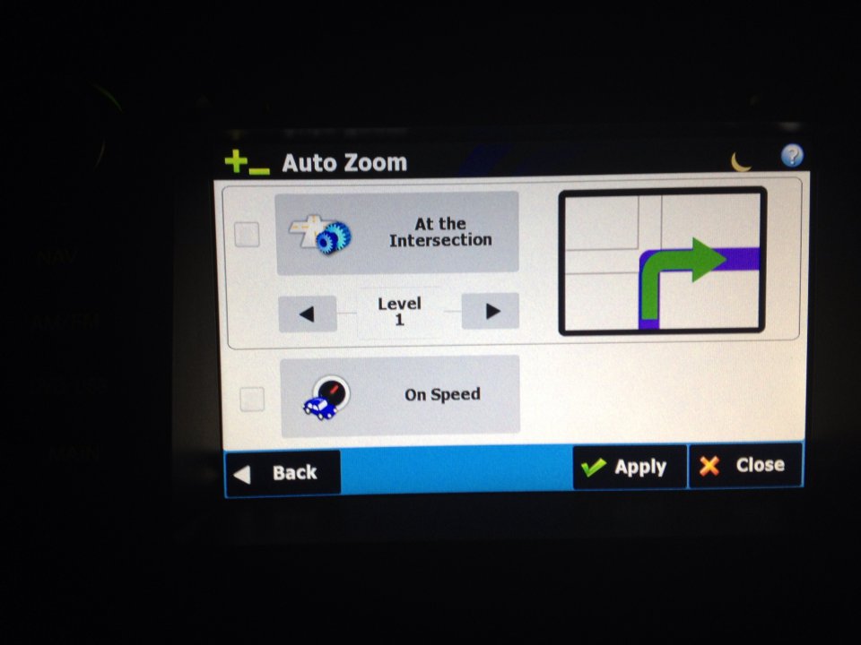

    The nav "auto zoom" can be disabled by unchecking both zoom options. With both unchecked the zoom stays where you set it.
