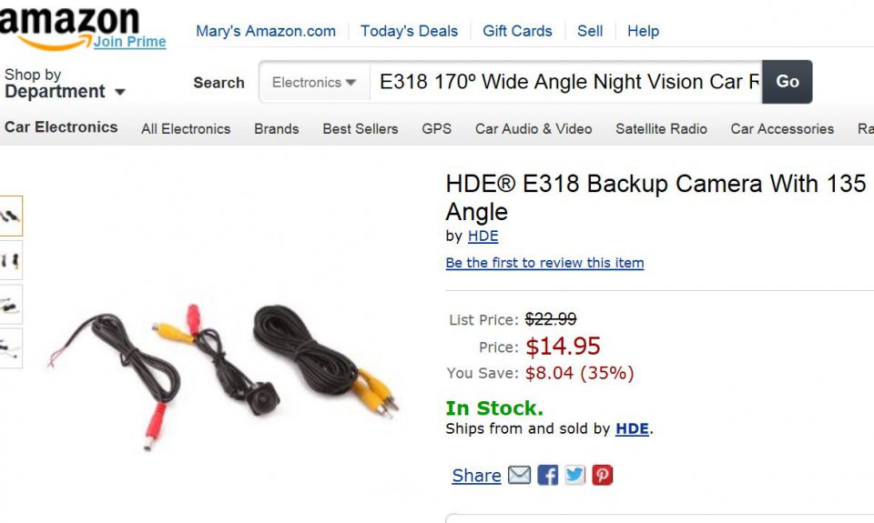

    I did a check on the eBay seller for the backup camera and he gets many hundreds of bad reviews. I think I'm going to get the same unit from Amazon dot com for a few dollars more. Notice how this seller shows the video and power cables. Here's the same product: Rear view camera.JPG

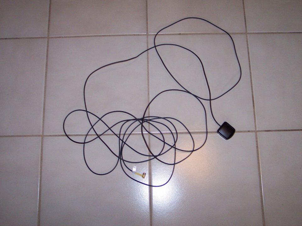

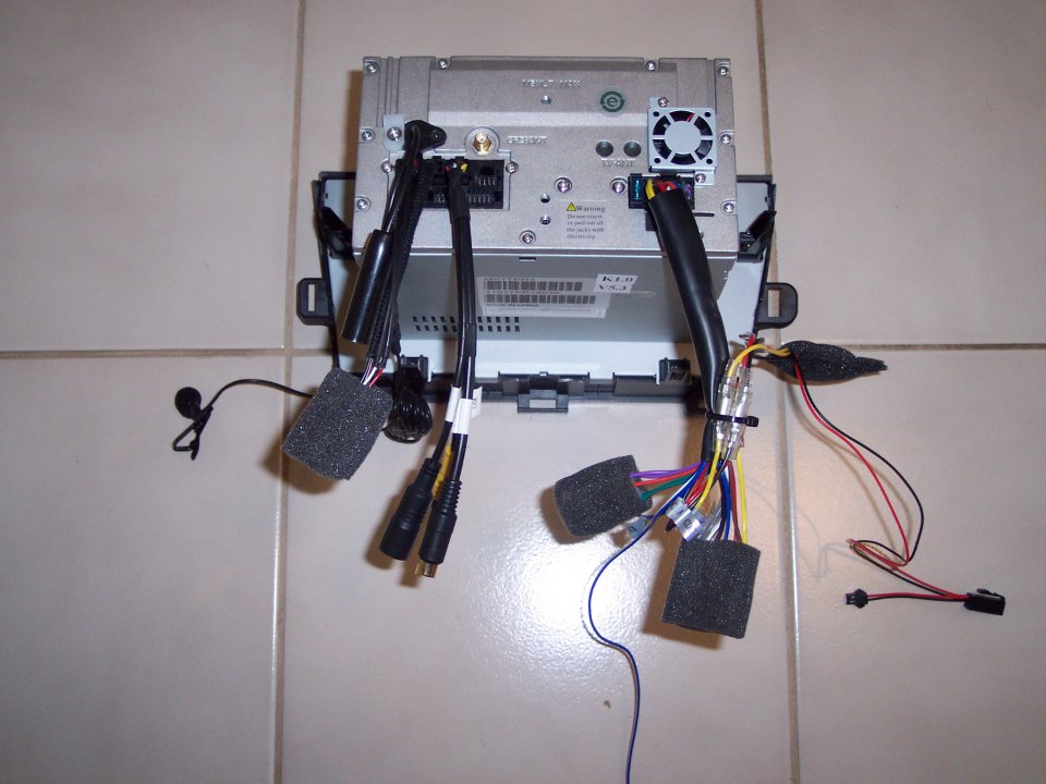

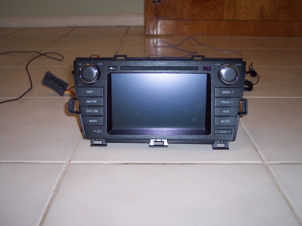

    NAV unit 001.JPG OK - it arrived but I'm taking this cautiously and slowly. Probably going to take more than an hour to do properly which will include wire-fishing the GPS antenna to the upper console area. BTW, their installation guide is very brief and leaves me with questions I may need to call M&D about.
    Anyway, I took some out-0f-the-box photos of the semi-prepared unit. According to the instructions, there are brackets on the old radio that need to be reused with their screws. Here are some pictures:
    evpv: where do you connect the "reverse" blue wire to? This is required if you eventually want to use the backup camera.

    Blue wire just grounds to chassis. I used a screw behind the upper glove box.

    1) The blue wire with the white stripe can be grounded to defeat the in-motion safety features, as you mentioned.
    2) The solid blue wire marked "back" must be connected to a wire in the joystick shifter that provides voltage when the car is in reverse. This is the only way the reverse camera option will work. NOTE: The camera itself needs a positive voltage (from the backup lights) too.
    3) Be careful about the GPS antenna mounting - the black plastic must face UP. You can use the black square metal piece they supply as a base for the mag-grab on the bottom of the GPS antenna. This can be tucked in the dash somewhere and it has its own sticky backing.
    4) The external mic for the Bluetooth is recommended - you can mount it in the blank under the Prius power up button and should work fine. Yes, there will be that foam sphere to look at but it's black and matches the blank. The tech says it should work fine - even 2+ feet from the driver speaking.

    3. My nav antenna is stuck to the top of the headunit using the built-in magnet. The factory mounts it above the AC vents and under the dash cover. It needs a 2" square metal surface for proper operation, M&D supplies a 2" metal plate with the unit.

    As far as the GPS antenna is concerned, i mounted mine in the middle of the dashboard very close to the windshield and the wire run through the passenger side, the passenger small window and the windshield. The wire can not be seen, and the reception of the antenna is excellent. Most OEM units have the antenna fitted there or at least it's there on my other cars. I can post some pictures if it will help you.
