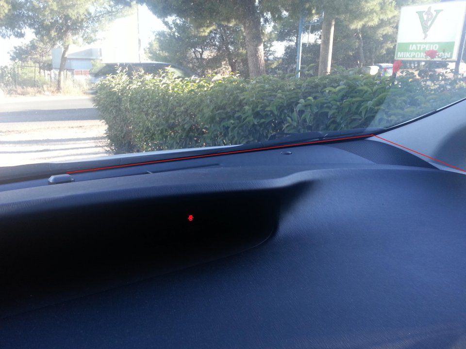

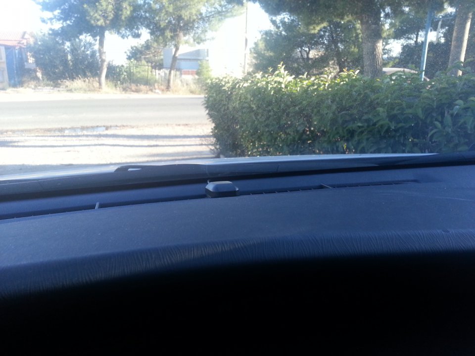

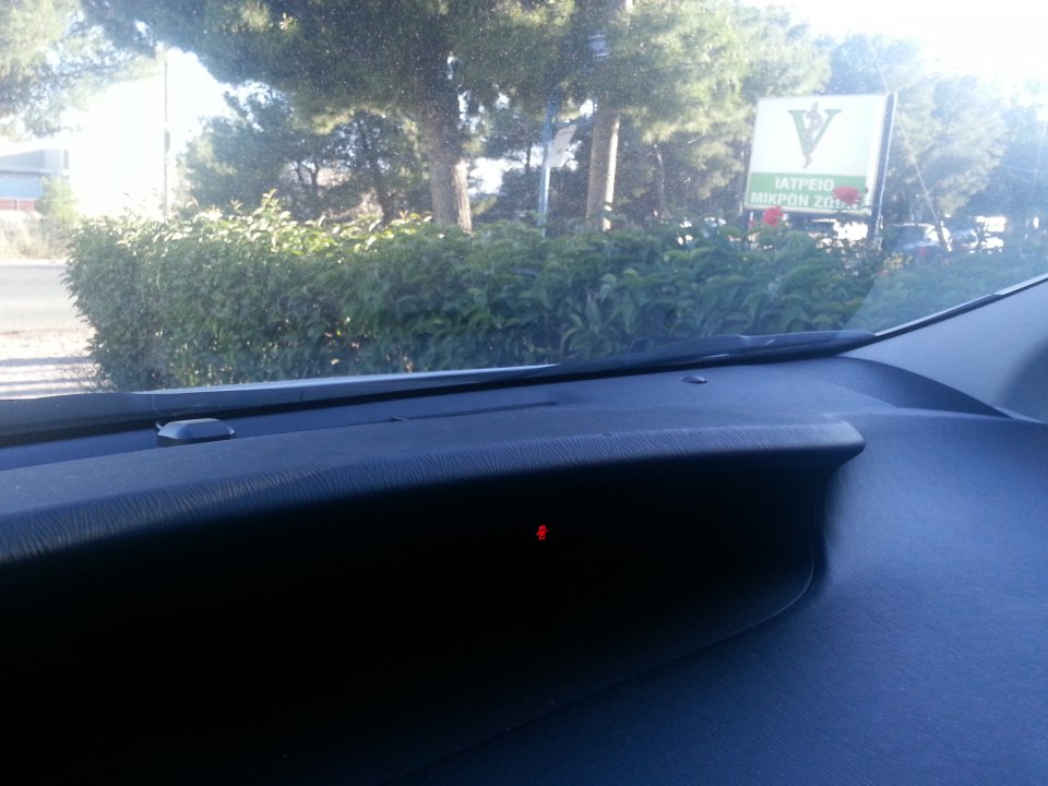

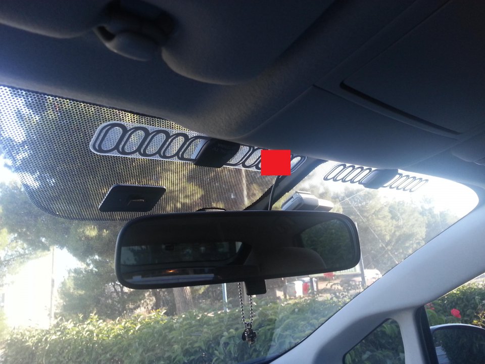

    I also got that message and freaked me out, but after a while it went away. Best to run the wire to the backup lights. Never had any problem with that. I had also positioned the GPS antenna at the windshield behind the rear view mirror right at the top, with a double sided tape and worked great untill i fitted the active antennas for the dvb-t tuner and that gave a lot of interfierence to the gps antenna and took a long time to lock in position. Moved the gps to the dashboard and everything works great. Let me go out and take a photo, it might help you.

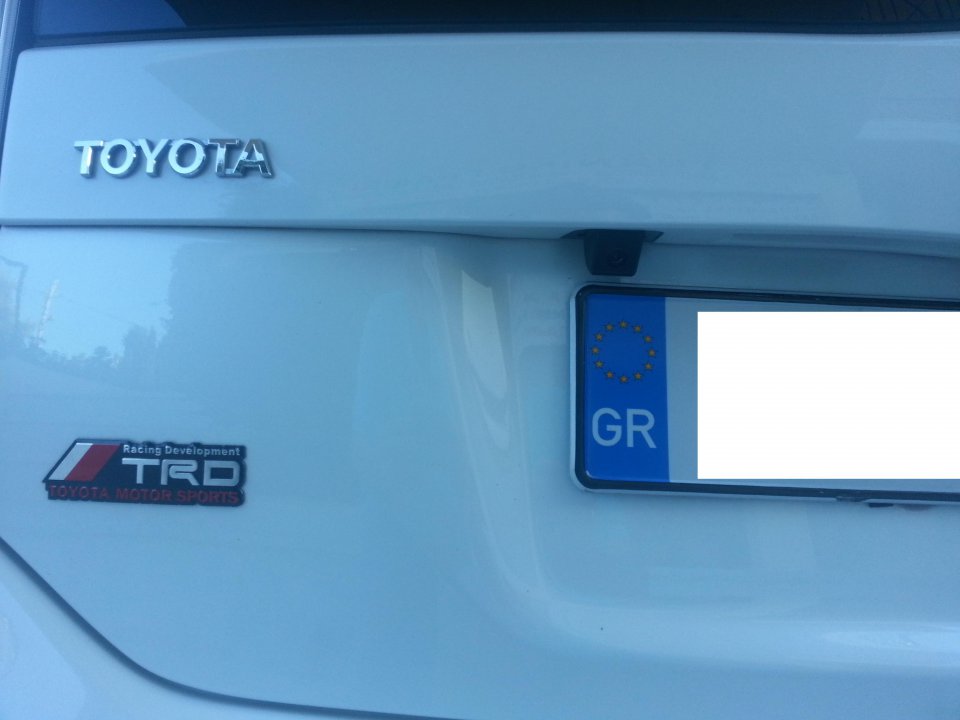

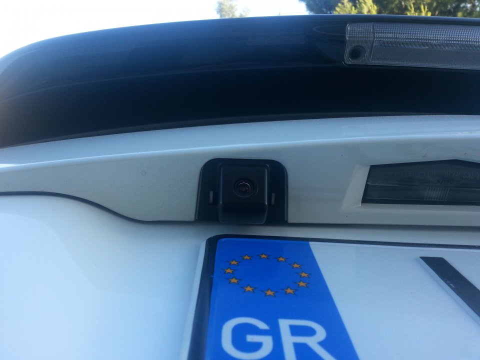

  9. Nikos
    Nikos Junior Member
    Sep 15, 2010
    24
    Greece
    Here are the pictures. Hope they help.
    Rear view camera.
    Initial position of the GPS antenna (interfierence from active dvb-t antennas)
    Final location for GPS antenna.
    GPS antenna location.
    GPS antenna wire rooting.
    phoenixgreg likes this.

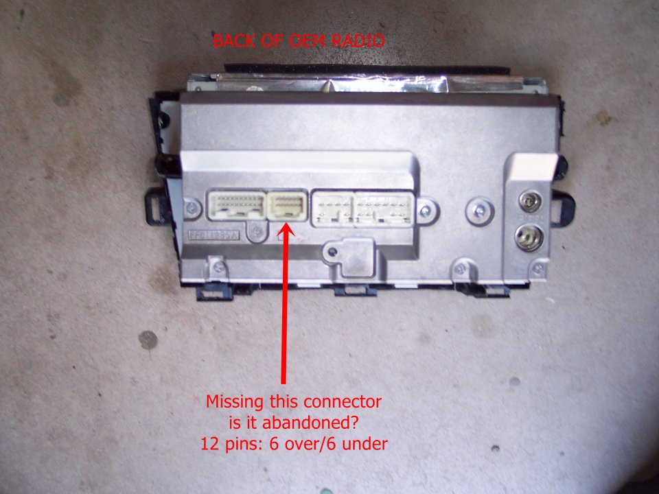

    Extra connector 001.JPG Thanks Nikos...one more thing. I've been on the phone with the technical rep about a strange issue. It seems there's an extra connector (12 pins - 6 above / 6 below) from the OEM radio that there is no connector for on the new NAV unit. Did you encounter this too or am I missing a part from the factory? Their diagrams don't seem to show it either. Thanks!

    Greece
    If I remember correctly there was a missing connector on the car. I think it was for the oem Bluetooth system that is no longer needed. I just left the connector in the car. You can plug the rest of the connectors in the unit, plug the connectors for the rest of the parts that you removed and turn on the main switch without turning on the car (press only once or twice the switch without the brake pedal) and check that the new unit it's working correctly. Just don't forget to plug in all the connectors that you removed so that you do not get any error message from the car.

    Thanks Nikos - the tech rep never called back so I took a chance and fired up the system. It seems to work fine but I need to go over all the options to be sure they are working properly. You've been a big help! Thanks again from afar!
    WARNING TO ALL WHO ATTEMPT THIS - THERE SEEMS TO BE AN UNUSED OEM CONNECTOR TO THIS UNIT. IT HAS 12 PINS: 6 OVER/6 UNDER. IF I LEARN THERE HAS BEEN AN OMMISION, I WILL POST BACK HERE.

    Greg, since everything work ok, and you're car had the oem Bluetooth system, like mine has, then the missing connector is for that. Everything in my car also works great and I also left a connector out.
