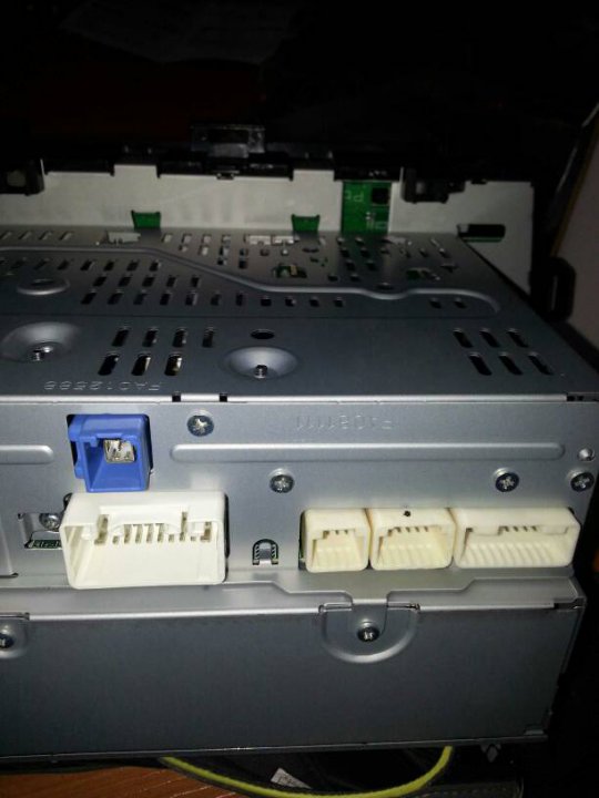

    Looks like mines won't be as plug and play. Here is the back of my stock JBL unit. uploadfromtaptalk1369493472513.jpg

    I can't see inside your connectors from your angle, but there's at least one OEM clip that should fit the M&D connector. Compare the harnesses from the new NAV to your sockets - if you have 3 that will fit, you should be OK.

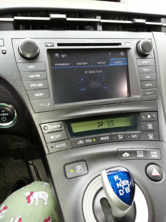

    My install was a success. Took longer because I had to wire up the JBL adapter. For anyone that has a Non nav JBL head unit you will need an adapter and then wire it like any other after market radio. So far on loving this unit. Just the fact that I can stream my music over bluetooth is worthit for me. I was able to stream Pandora from my phone over bt as well, was even able to skip using the steering wheel controls. Haven't even tried the navi and backup yet.

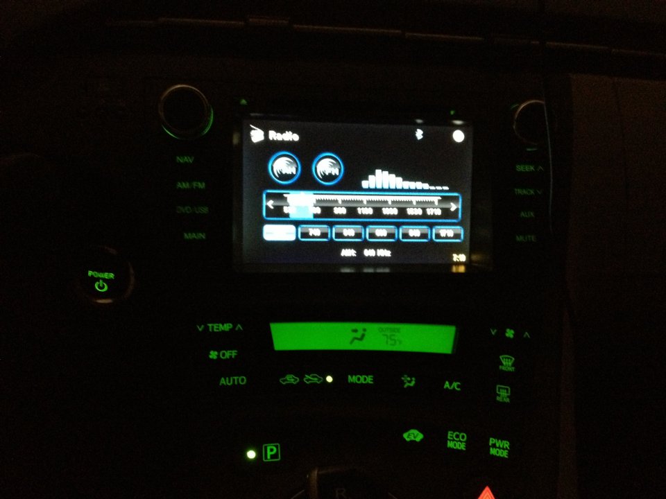

    Congrats :) Hopefully by now you have the DVD player working. I wonder if you could do a test (you might have to wait until after dark): Turn on your headlights and bring up your dash lighting to full brightness (thumbwheel left of steering wheel). Are the new NAV's buttons the same brightness as your dash? Mine are very dim and I could not figure out how to bring the NAV system up to match the rest of the backlit buttons. Maybe someone here knows of the "hidden code" on how to do this.
    TheredBull likes this.
  15. TheredBull
    TheredBull Junior Member
    May 23, 2013
    30
    Southern California
    This is what i get with dash lighting to full brightness. It is dimmer comparing with OEM backlit buttons.

    Thanks for the test...mine does the same. I'll contact their tech group on Tuesday to see if there's a way to change it.

    I don't think the brightness or color of the buttons is adjustable on our units.
