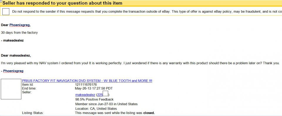

  13. phoenixgreg
    phoenixgreg Senior member
    Apr 7, 2010
    1,157
    291
    66
    Phoenix
    I contacted the seller on eBay and got a fast response: (bottom line - 30 days)

    evpv: thanks for that picture. I checked my box and it looks very different than that picture you posted with no mention of a 3 year warranty. I'm tempted to contact M&D directly to ask them about it. I helped a friend, who also bought this same unit, install his last night. Between the 2 of us, we had it in and running in 3 hours. Some of that time was spent customizing the extended BT mic in one of the OEM blanks. His phone initially did not "pair" with his new system and we found out the problem: It seems if there are more than one BT connections set up on a phone, the M&D "hangs" on the pairing. Essentially, it needs to have just one BT setup for the intended phone. Have you tried this to resolve your issue? Anyway, if I find out more on the warranty (the eBay seller has stated 30 days), I will pass it on here. Sure wish I had that 3 year warranty somewhere in writing on my materials.
