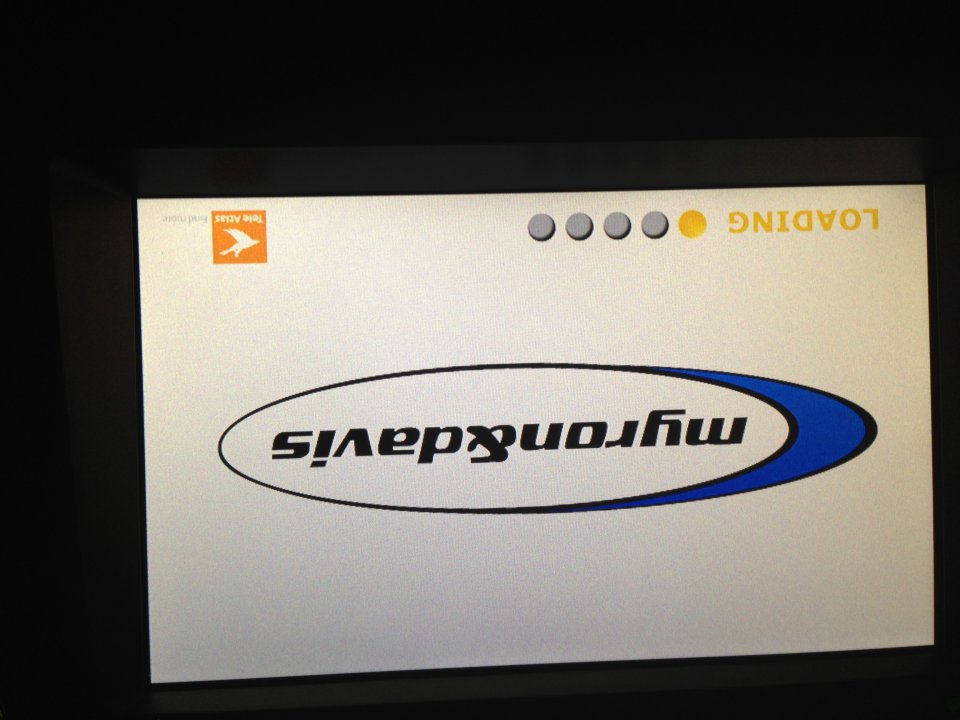

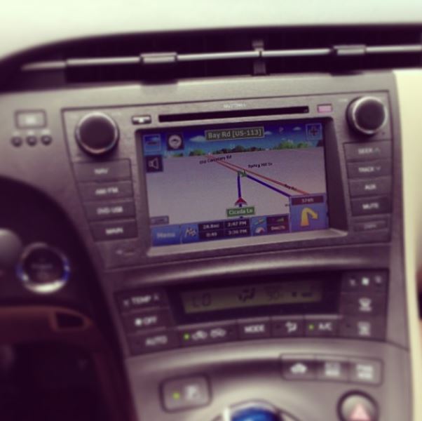

    So far, everything is working perfectly and I've assisted on a friend's installation and it's good too. Yes, I get that loading screen as shown by Kenny, but after that a map appears with a blue boxed message "acquiring satellites". Then normal NAV functions start to happen. So here's a quick checklist here to be sure your installation was OK:

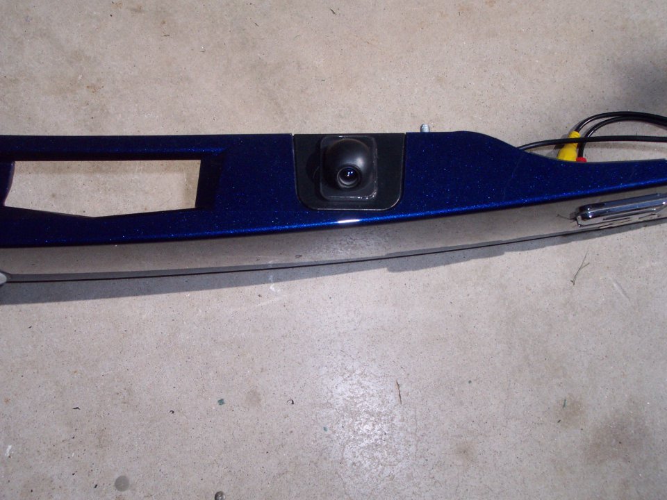

    Thank you for your help to Prius chat members. I just received my backup camera. Can you give me some pointers on how to install it? How do u tap the wire for camera and head unit? Thank you very much.

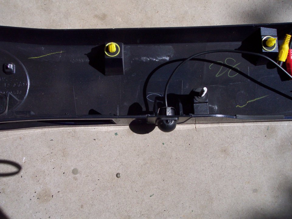

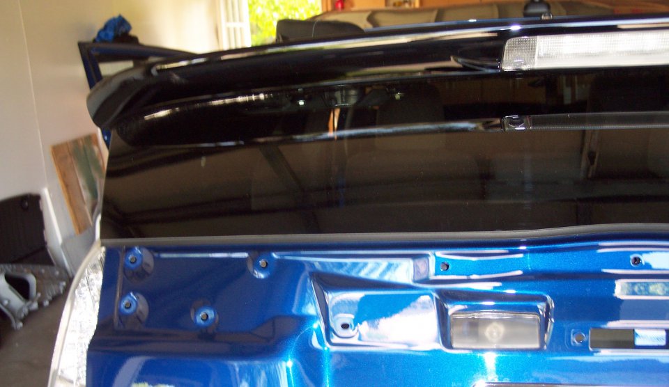

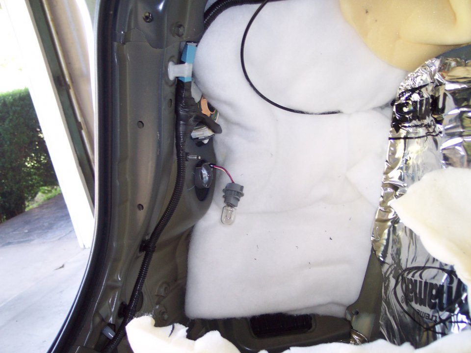

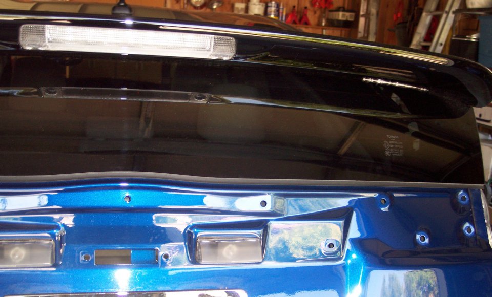

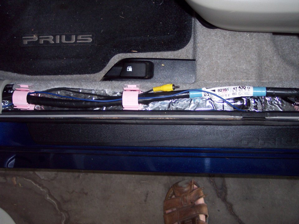

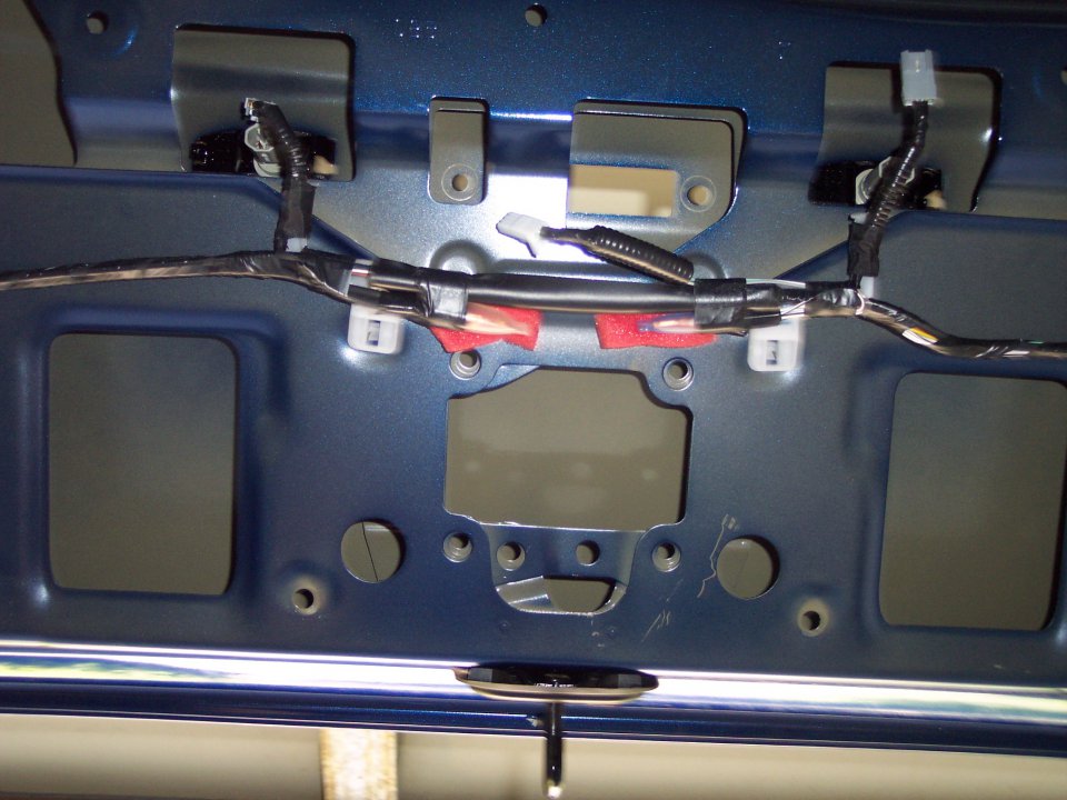

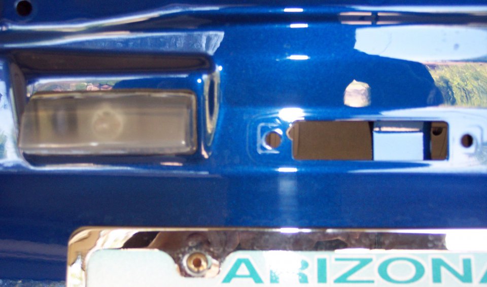

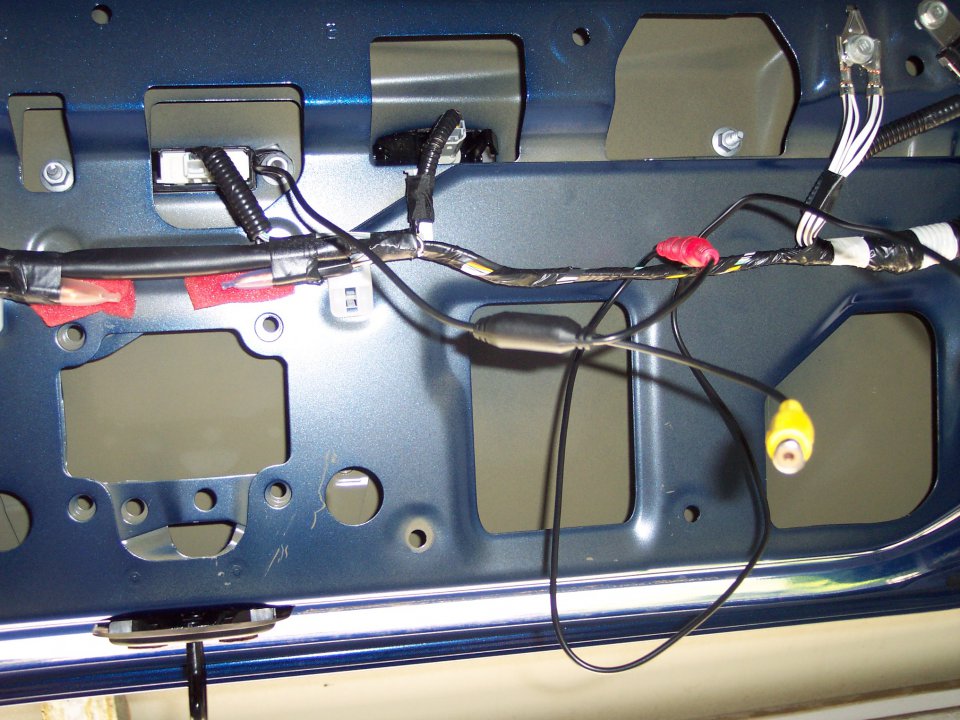

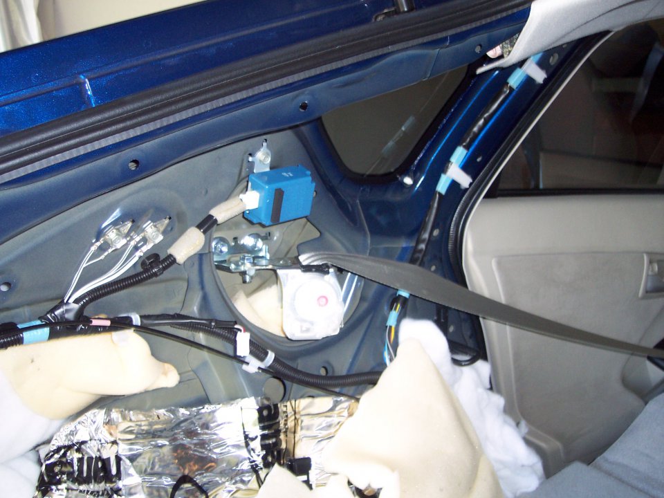

    Rear camera installation 001.JPG Rear camera installation 002.JPG Rear camera installation 001.JPG I think the backup camera is a tougher job than the NAV unit install. Hopefully, you have already routed a video cable (yellow connectors) from the back of the NAV to your driver's side channel under the door. Also, you should have extended the wire labeled "back" to that same channel. You will need a male-to-male video cable connector to join your extension to the provided video cable. I will post some pictures of my benchmarks, but they are an over-simplification of what you need to do.
    First, watch the video someone posted several pages back on this thread. He is right on the wire fishing needed thru the rubber conduit between the hatch and the car body. You will need to pop out 3 flat plastic body connectors towards the rear of the headliner to get access to that conduit. One thing I suggest is to not remove the lower part of that conduit as it is nearly impossible to reset. The top part that goes into the hatch is easier to deal with. I used a long zip tie with soap as was in the video to fish the long video wire (provided) and my own red wire (long enough to get to the camera's red wire and to the backup lamp.
    You will need to remove all of the black plastic housing on the inside of the hatch to get access to the areas for the camera. They pull off with connectors, but be careful not to break any or scratch any surfaces. Then you need to remove the panel below the small back window with "Hybrid" on it. There are 4 nuts that are visible from the inside that you remove. Then carefully work from one edge (passenger's side) and pry it away from the hatch. Go slow as there are several yellow plastic connectors that pop out. Once that panel is free, you can pinch/pry out the blank where the camera goes.
    What I did was bore a hole from the back of that blank using a 3/4 inch spade bit (wood underneath for a clean hole). You should see a small silver bracket on the top of the camera. What I did was carefully remove the 2 screws and with a tin snips, very carefully cut a slit from the outside of the tin circle towards the center hole where the cable is. DON'T DAMAGE THE CABLE. Now you can gently bend that tin bracket along the slit to remove it from the camera. You will be reusing this piece. Now feed the camera's cable from the smooth side of the blank you drilled and make sure it's facing out (if I recall, the rounded corners face outward). With the camera in place, carefully put the wire back thru the slit you made on the tin piece and that will be how you mount the camera into the blank. Bend the 4 tabs so they lock on the back of the blank. Replace the screws. Now you can put the assembly back into the "hybrid" panel. I hope you have a Dremel tool. What I had to do was create a rounded area for the camera cables to pass into the hatch on the left side of the body opening in hatch where the hatch opener goes, then line it with electrical tape so it can't chafe. That is where I routed the camera wires out from. Now you can reassemble the hybrid panel onto the hatch and replace the 4 nuts. The rest is routing wires along existing wires in the hatch to your fished wires.
    WARNING: there is a black and red wire on the camera power jack. Only attach the red wire to the red wire of the backup lamp - the black wire is not used - do not connect it to a ground! I almost messed up my ECUs! After that, you route your red wire to the red wire of the backup lamp and also from that same wire, route a connection to the wire you extended from the NAV that says "back". Before putting all your panels back on, test the camera. Good luck

    Wow, you did a wonderful job. Installing backup Camera is a big job :). However, based on your information, I think I am ready to tackle this job :) Thank you very much.
