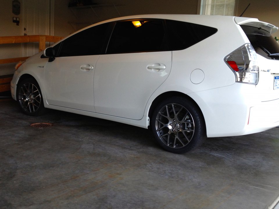

    Here are some 18" TSW's....
    PearlJammer, NadaMucho and orenji like this.

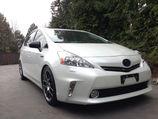

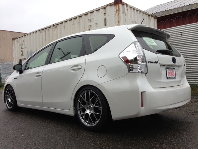

    Enkei 18" Lowered
    h-dogg and NadaMucho like this.

    Your V looks really nice....more pictures!

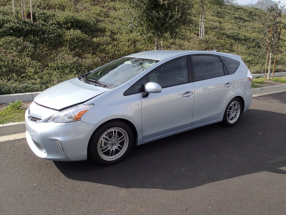

    PC240533.JPG LIGHTEST PRIUS v WHEELS
    I changed my 16" Two model wheels to 17" X 6" ENKEI RPF1 wheels. They are absolutely the lightest wheels I could find anywhere with the gen III Prius bolt pattern and proper offset.
    Yeah, I briefly thought about 18" wheels but i wanted the lightest I could find and 18" RPF1 wheels were just too much more weight. Rotational mass is nearly 2 times the effective weight as static weight on the car. That's one reason super cars have carbon brake rotors.
    I put Yokohama YK 580 V-rated tires on the ENKEI rims. They are a Discount tire tread pattern but the body is Yokohama's top end tire with orange oil in the tread compound for better gas mileage and wet traction.
    Photo here also shows car after install of Tanabe lowering springs. (Hood accidentally left partially open after photographing cold air intake.)
