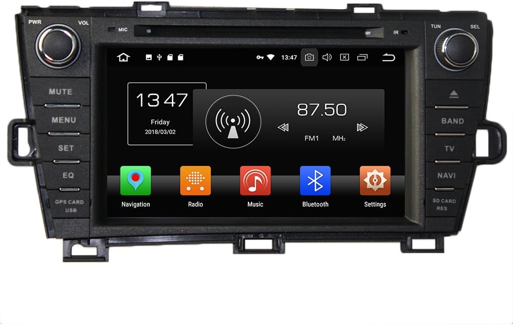

    Just saw this on youtube and it looks like a great mod. It has back-up camera capability, 3G/wifi, bluetooth, android os with apps, steering wheel controls, etc.
    Not to mention it looks like it came from the factory. Completely matches the dash color.
    What you guys think?

    Installed a Chinese made (from eBay) 9" android unit into the Prius this weekend, also added a sorely needed reverse camera.
    Overall happy with it, even though the left side isn't completely flush as it's supposed to be, vendor failed to ship along two metal mounting plates that force a flush mounting position. It's otherwise very secure by the trim pieces alone as the unit is very light in weight.
    Sound quality seems improved for the radio, but lacking a bit when playing audio files compared to the OEM stereo (I had the small touch screen).
    Bluetooth is vastly improved. I don't know if my stock radio had an issue or if it's common with the stock unit, but the bluetooth reception wasn't very good at all for phone calls or streaming music.
    GPS works, even though I'll likely never use it as I have my GPS on my phone.
    Steering wheel controls work, you just have to program them, very simple, takes a minute.
    It has two USB ports, one is wired to the stock location in the armrest (needed a $10.00 connector sourced from Amazon), the AUX connection there also works. The other USB port I ran to the port below the center the dash next to the 120v outlet. I'm still searching for a USB dash plug that fits here. It's just a lose wire hanging out for now.
    I have all the functionality of an Android tablet otherwise, apps, games, movies, wifi etc. Instead of using a flashdrive for my music, this unit will recognize a small 2.5 portable hardrive (like a laptop's HD), I believe up to 1Terabyte. I'm currently using an older 320gb unit I had laying around.
