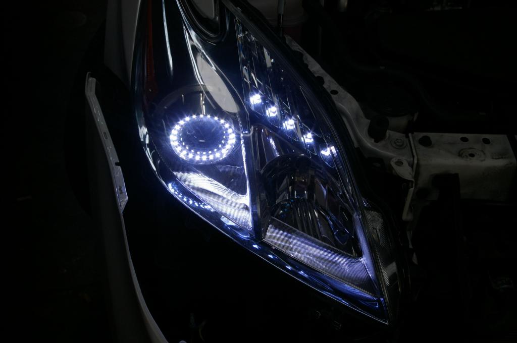

    How bout these...

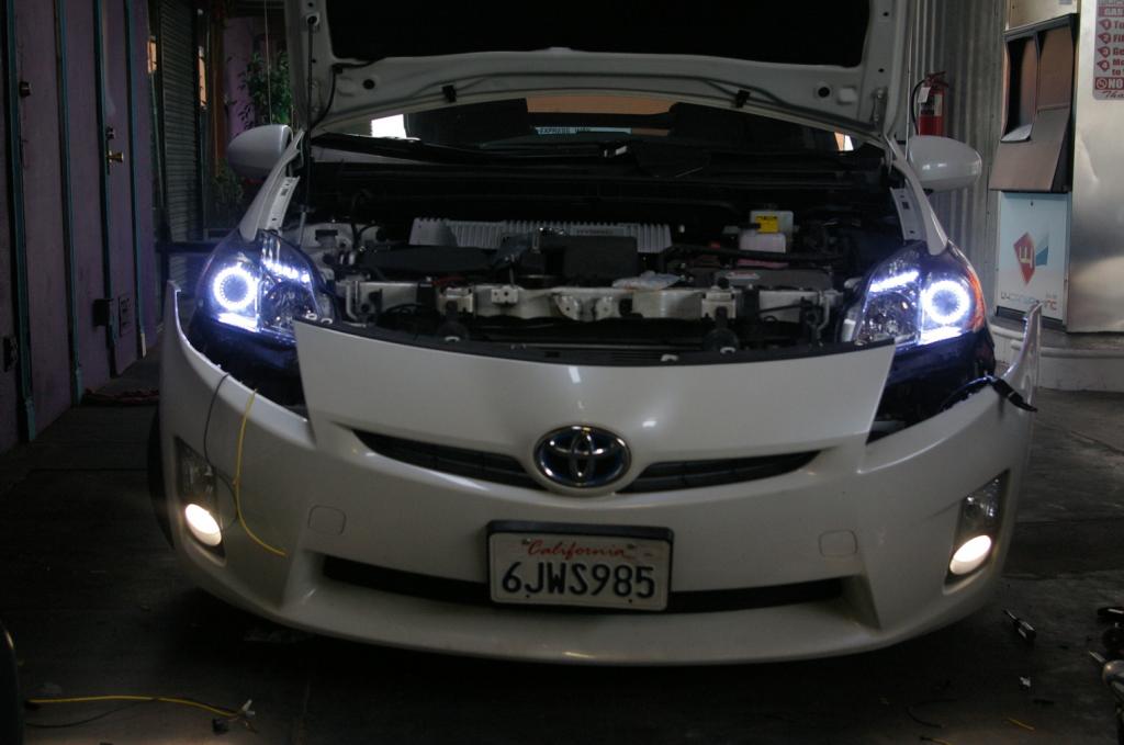

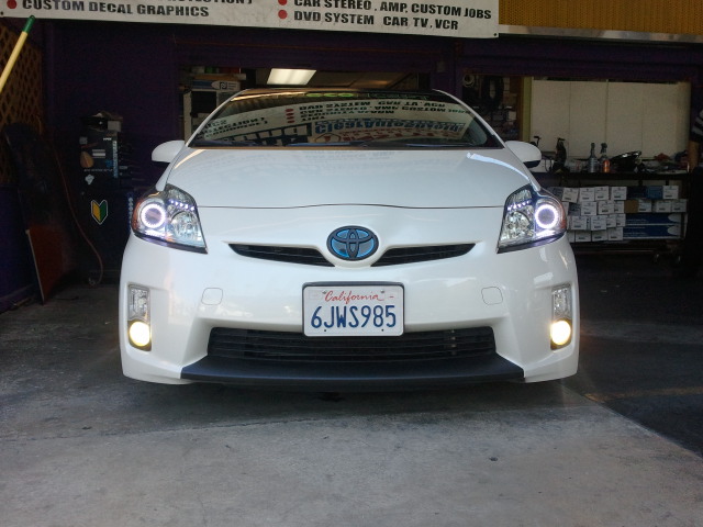

    So my headlights and maybe there are two others with the same set up was modified by a friend of mine at his shop.
    They did sell these at one point but not enough interested to continue.
    Traditionally the modification process is the same...heat gun and remove the cover...LED ring board and LED's were installed right around the projectors which was just enough room to fit it perfectly behind the plastic mold. Holes were drilled for the five leds that was fitted behind the mold for the inner rows. Also a group of LEDs were installed on the side amber reflectors and then added the signal for low and high 's for the leds on the side.
    Clean and put right back together.

    Hmm, I suspect that the LEDs aren't bright enough to be seen in bright sun, making them unusable as DRLs.
    Pictures/videos posted so far are in dim, low light conditions.
