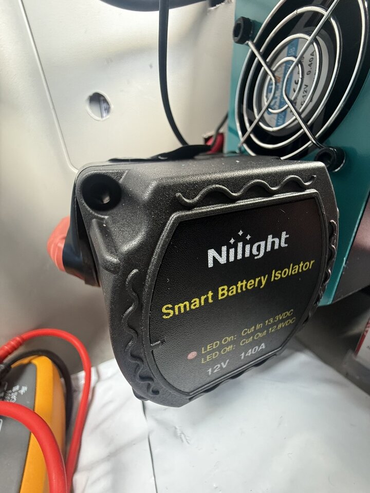

    Long delayed follow up. I got the 12V battery replaced under warranty and immediately after I installed a voltage sensing relay directly to the +12V inverter tab. This solved everything and has been working great for a year now. No more dead 12V battery and the inverter now automatically turns on/off with the car.
    Nilight 12V 140A Smart Dual Battery Isolator VSR Voltage Sensitive Relay
    Brian1954 likes this.

    A 60A relay would've been cheaper, trigger voltage that closes the circuit when car is powered-on or a manual RV battery switch. That's a little more work and doesn't automatically power-up. Either way, you'll get circuit isolation, so it can't kill your battery while your away.

    No offense; Not nitpicking your solution; just the first time I saw this thread; since it bubbled up on recent post. It seemed obvious to me that you had a bad inverter power switch that wasn't fully disconnecting/shutting-off. So if you didn't want to replace the inverter, you needed to come up with a way to isolate the circuit, so you don't have to jump start and eventually kill your battery from continuous full discharges.
