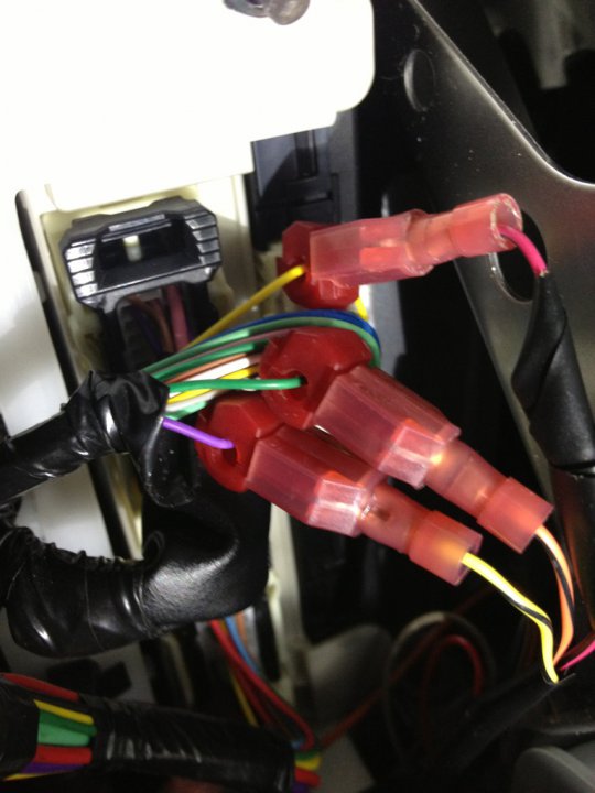

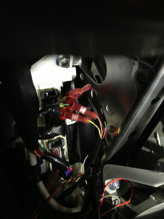

    Sorry for the mess in here. Yes, shame on me, I still have not gone back to solder those connections.
    IIRC the wires are either 20 gauge or 22 gauge. Yes, they are small. I think soldering them will be a bit difficult in this area.

    Any tips on stripping the wires in place? I assume removing the ECU harness is a hassle and would not give significantly more working area. I am thinking on using a boxcutter with a new blade and stripping a 1/8" section on each of the three ECU wires VERY gingerly and then mounting the T-Taps. That small gauge wiring is tricky.

    There is no need to strip wires prior to using T-Taps. Slip the wire into the T-Tap and press down firmly until it clicks - the T-Tap will strip the wire for you. Also, you may want to cut back more of the insulation and move further down the harness, since the location of my T-Taps seems to be putting some stress on the connector.

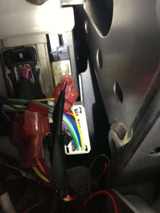

    The most difficult part was finding the #16 green wire. There are a number of green wires. You just need to be observant. The #4 lavender and #30 yellow wires were much easier. I took The Critic’s advice and teased out the wrapping after I disconnected the ECU harness (just a clip on the left. The wrapping is sealed at the top and can be pulled apart. Before doing any of this I disconnected the negative battery terminal.
    To get to the ECU you will need to remove the flashing next to door sill, the kick plate, the lower left dash panel, and maybe the plastic plate over the OBD connection (can’t remember).

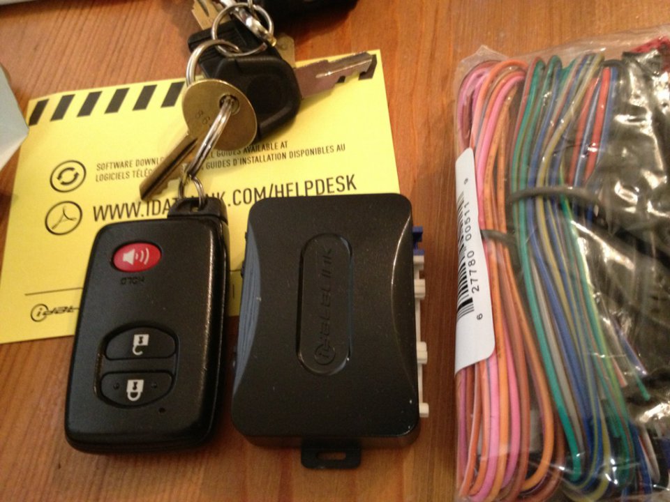

    To others: I just received an idatalink ads-al ca that I will be using for a different car. Although the idatalink does not have a t-harness available, it does have an advantage in size. It is a much smaller unit, which will make it easier to mount. Also, the reliability is supposed to be much better - though my DB-ALL has been working fine so far. ImageUploadedByTapatalk1370918762.066672.jpg
