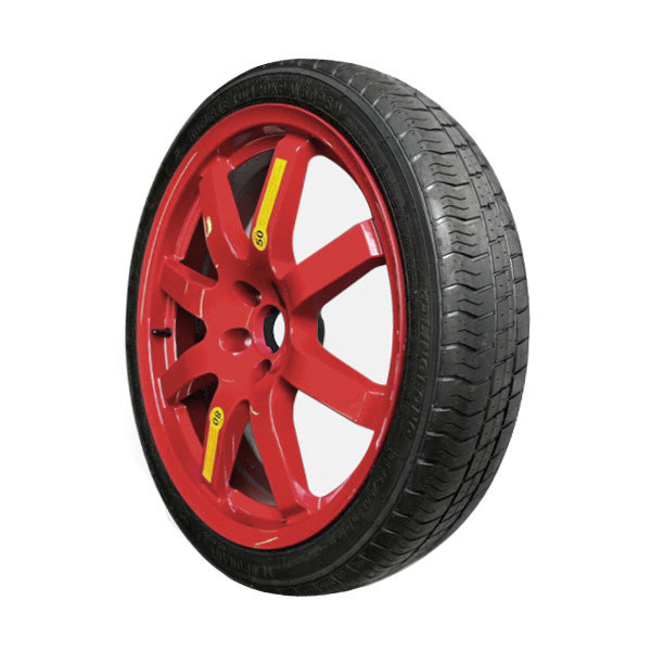

    Your posts on this topic have been very helpful, so thanks for that. The toyota parts (especially when discounted) are very reasonable. I am going to get the toyota jack for sure, I do not need any tote bags. That said, it appears that the toyota designated prius spare is a steel wheel, which is no big deal, but it is heavy. I wonder if getting an aluminum wheel spare (from ez-spare) like this is going to save me a few pounds of weight vs the toyota steel wheel? Your thoughts?

    For what it's worth, the ModernSpare weighs 31lbs for the rim and 135/80/R18 tire according to @KH111. I purchased the OEM steel spare rim and a 145/90R16 tire and the total weight was 29lbs.
