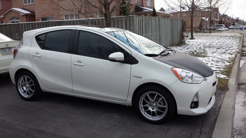

    Prius C4 with Enkei PF01.

    Looks cool. Almost like the work emotion.
