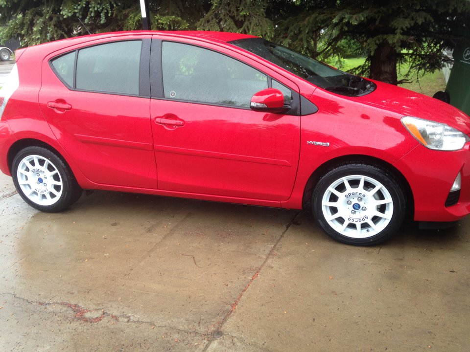

    Wheel Brand: Sparco
    Wheel Model: Terra
    Wheel Weight: 18.9lbs
    Size: 16 x 7
    Offset: +42mm
    Tire Size: 195/50/16
    Tire Pressure Monitors: Perfect fit!
    Difference felt in ride quality: Definitely firmer
    Price Paid: $1400 mounted with new Falken Ziex ze-912 (darned import fees for Canadians)
    Fitment Issues: None whatsoever.
    Couldn't be happier with how they look! I wanted to go for the subcompact hatch Rally car look - and I think these rims fit that image quite well. I haven't noticed any real detriment to milage, but then; I haven't done any official math yet. Rhino roof rack and Weather Tech mats are on the way. Will post pics when they come in! Looking at doing the HID/White LED replacement and a front strut bar for future mods.
    Let me know what you guys think, cheers!

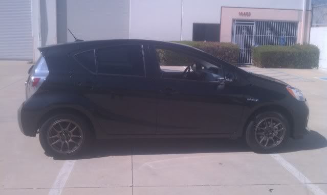

    Could you please post picture of the whole side of the C with these rims ?
  11. HiC
    HiC Junior Member
    Aug 26, 2014
    23
    16
    Northern, MN
    2014 Prius c

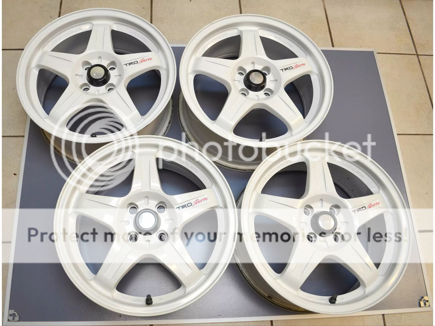

    So just purchased some trd wheels. Specifically 16x7 33 offset and pictured below. My question is, I'm lowered on DF210 and need some tires that won't rub or need me to roll fenders. Any suggestions? My brother has a pair of new 205/45. Not sure how those would fit. [​IMG][/IMG]
    orangenerd and Motov8r like this.
  19. Motov8r
    Motov8r Member
    May 25, 2014
    102
    2013 Prius c
    I am running 16x7 with 45mm offset with 205/50. They rubbed so I added a 10mm spacer which makes it a 35mm offset effectively. You should be fine with 205/45. I am lowered with NF210 but have a lot of weight in sound deadening and stereo so riding a little lower than typical NF.
    Also, those wheels are kick nice person.
    mertechperformance and MaXPowers like this.
