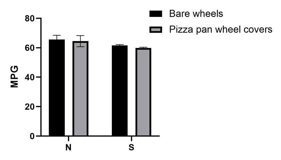

    An ordinary two-way ANOVA of the raw data reveals that the direction of travel (North or South) had a significant effect on the consumption (P=0.0269), but whether or not the wheels were covered had no significant effect (P=0.3690).
    Directly comparing the means, as the experimenter did in the original post, does not account for the variations within each measurement condition and yields no useful information.
