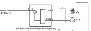

    Sorry, yes it is 1.68kΩ I did 20k resistance test.

  3. Mendel Leisk
    60,276
    41,473
    Apparently covered in my previous attachement?
