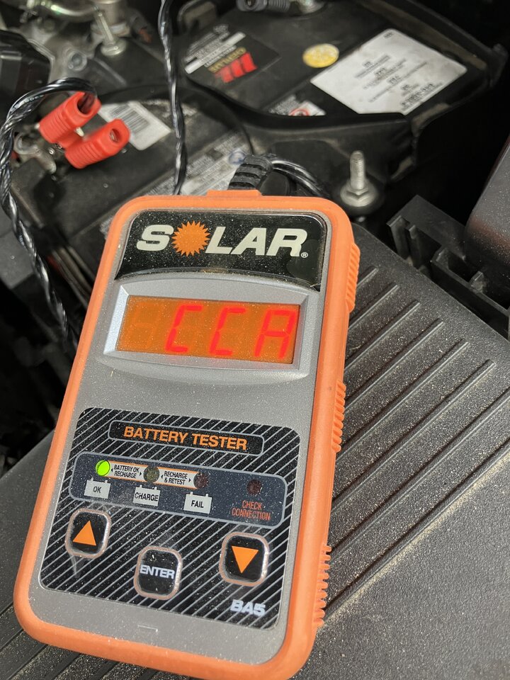

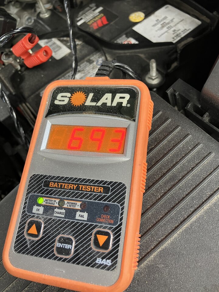

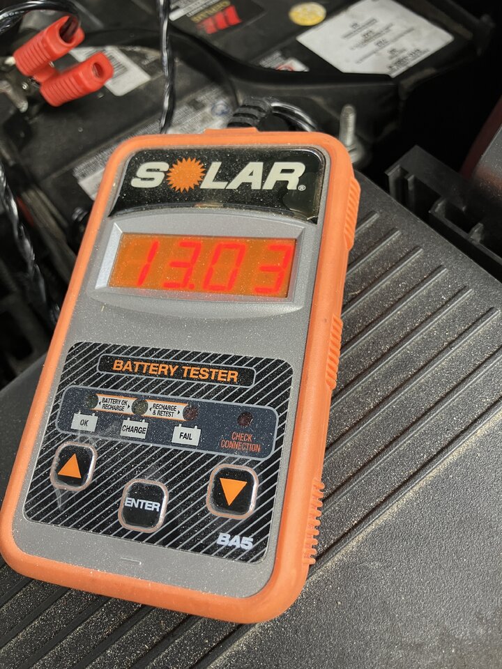

  18. Mendel Leisk
    61,593
    42,369
    very likely. Any battery that’s sat for 6 months, with the typical load a modern car imposes (even when off), is almost certainly toast. I wouldn’t hesitate, just replace it, with proper spec battery mentioned above.
    If you want to check its viability, an electronic load test is superior to voltage check.
    Dealerships will do such tests but not for free, automotive retailers selling batteries typically have such testers too, and will usually test for free; it’s good for business.
    the testers ask for a few of the battery’s specs, run a load-test, typically for CCA (Cold Cranking Amps), and give a verdict on the battery’s viability.
    you can buy such testers, prosumer level, for about $40~80 USD. I’m using a Solar BA5, works well:
    CCA option
    Voltage
    CCA & verdict
    Current version is BA9.

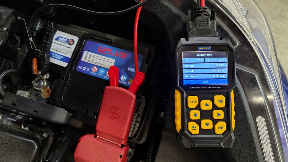

  20. TinyTim
    TinyTim Active Member
    Nov 23, 2016
    418
    243
    Seattle
    2017 Prius
    I bought a replacement AGM battery last month. I bought a battery tester to monitor my old true start battery. It's very accurate, I have tested it on several different vehicles over the last year. Everything is in color and the screen is big. I just tested my Prius AGM battery.
    I also have a 10A battery charger/reconditioner that has an AGM charging setting.
