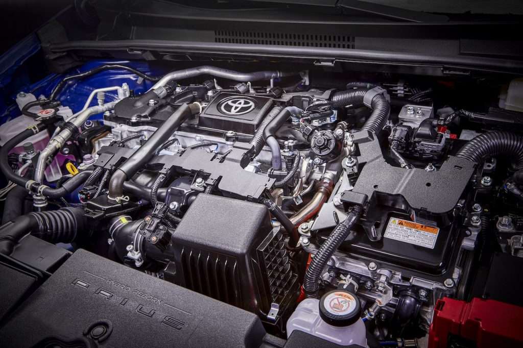

    Yes. The M20A engine is a bit bigger than the 2ZR, so the battery has been relocated to the back again. Gen5s with the 2ZR(like the Mexican Prius), have the battery in the front.

    interesting... also interesting, I have 3D scans of both engines and I tell yah, the size difference isn't by much! I mean, you can bore a 2ZR out to be basically the exact same 1,987 cc and the block walls would still be strong enough to support it. but the size... worked out and that's how I was able to install the M20A into my 2013 Plugin, just getting it to run in EV mode up to 80mph like my 2017 Prime... I need to find a company with the machines to make the sprauge clutch for me based on my files... hence the delay in finishing it all up. but still.. interesting on the battery placement. safe assumption gen 5 its in the back passenger side?

    I think it's less about the total size, and more about where that size is. I think the M20A has an intake manifold that projects further forward. That means there's no room for the air intake box in front of the engine like in the 2ZR gen5. The solution was to move the air intake box to the front left corner of the engine bay, which is where the 12V battery sits in the 2ZR gen5. It's also possible that the more powerful M20A needs a bigger air intake box or filter compared to the 2ZR, and that's part of the reason for the relocation.
    And the new battery location is indeed in the back passenger side, just like the gen3. I went from a 2010 gen3 to a 2023 gen5, so there's been no change for me.
