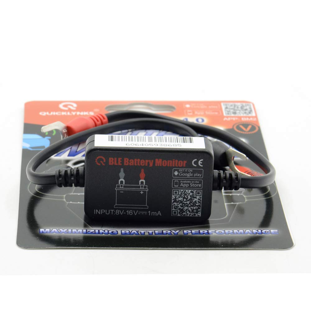

    I don't know which one you used, but BM2 draws a small current of about 2 mA.

    I am not sure what you used. The entire point of BM2 is that it stays permanently hooked up to the 12-V battery so that you record the voltage to 0.01 V every two minutes.
