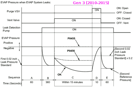

    In gen 3, there is a self-test of the evaporative emission controls for the fuel tank that begins several hours after parking and turning off the car (in gen 3, I thought the schedule was 5 hours after turning off, but that could be extended based on temperatures). I'd guess this is the same thing. The power is going mostly to the leak-test pump, which runs in stages B through E of the test:
    The pump can run anywhere from about 7 minutes to about 22, depending on how long stage C takes.
    I think we usually use 'parasitic' to mean drains that don't happen on purpose, so it wouldn't be quite fair to call this one 'parasitic'.
    I don't think the evap test will run repeatedly if the car is just left alone for a few weeks. I think it'll run the one time, several hours after the car is left there.

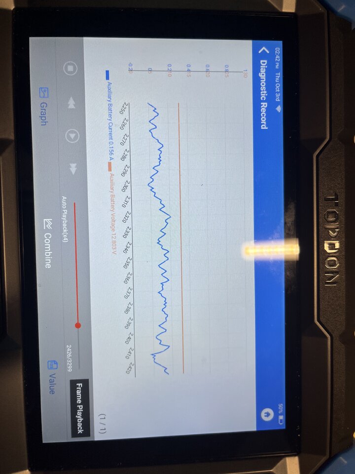

    OK, here's some data to digest. I hooked up my Topdon Phoenix Lite 2 scan tool this morning. The data streams I recorded were AUXILIARY BATTERY VOLTAGE (ABV) and AUXILIARY BATTERY CURRENT (ABC). The car had not been driven since yesterday morning. Starting battery voltage before READY per my BM read 12.41 volts.
    READY mode enabled, scan tool (ST) ABV 14.219 volts and ABC 7.160 amps. ABV stayed constant at @14.2 volts but ABC started to slowly decrease with time to @3 amps at which point the ABV decreased from 14.2 volts to 12.8 volts As the ABV decreased, the ABC decreased and went negative -4.345 amps when the ABV read 12.795 volts. The ABV held steady at @12.8 volts and the negative ABC started to decrease (lower negative current). The negative ABC held at negative 0.5 amps for a time period. Then the negative ABC dropped off and would pulsate from plus/minus current of about 0.1 amps. With time, the ABC stabilized positive @ 0.2 amps with ABV holding steady at 12.8 volts.
    I was recording while driving the car. Came to a stop and noted ABV increased to 13.599 volts and ABC now 3.803 amps. ABC would slowly decrease but ABV stayed stable at 13.6 volts. ABV deceased to 12.8 volts and ABC now negative 2.041 amps. With time and ABV stable 12.8 volts, the ABC negative current slowly became less and went slightly positive before I shut the car down.
    NOTE: I am unable to correlate times with the data stream frame shots unfortunately. I don't use this ST often enough to be that knowledgeable on how or if it can be done.
    OBSERVATIONS:
    The ABV as read on the scan tool data stream was in exact correlation with the voltage meter I have plugged into the 12 volt outlet on the center console.
    The scan tool shows a stabilized 12.8 volts but a pulsating ABC. See snapshot below.
    One other observation. On the upper right corner on the scan tool is a voltage display. This voltage would constantly fluctuate typically plus/minus 0.3 volts or possibly more. Hard to capture. I did note seeing @14.5 volts as the highest on occasion. This voltage reading is from pin 16 on the OBD2 connector which I confirmed with Topdon.
    My takeaway is that the charging system (BMS) for the aux battery seeks out and stabilizes at 12.8 volts. The pulsating ABC is most likely from the pulsating voltage that the ST sees on pin 16. I don't have a WD to see how pin 16 taps into and where. I haven't been able to find a data stream that monitors pin 16 voltage. Pin 16 is typically described as battery voltage. So why the difference between ABV and pin 16 voltage ???
    From what i saw and recorded today, short trips will definitely drain the battery over time.
    I'm charging the traction battery and plan to leave cable plugged in to see how my aux battery reacts. After that, plan to install the AGM battery and do a similar data stream recording.
    Cheers
