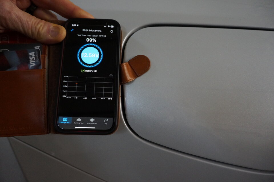

  20. Roy Peterson
    Roy Peterson Member
    Feb 11, 2024
    97
    126
    Richland WA
    2024 Prius Prime
    Car had not been driven since yesterday morning. Garage temp about 45 F.
    Prior to plugin of charge cable, battery voltage 12.59 volts.
    After plugging in charge cable, battery voltage 14.34 volts.
    After about 6 minutes charge time, voltage dropped to 13.05 volts. I have seen the voltage at the 14 volt value for times as long as @20 minutes. Traction battery only needed about 90 minutes to get to 100% as battery was about half range - this with a level 2 charger.
    After a few hours time post charge cable removal, the aux battery voltage reads 12.64 volts.
    Charging the traction battery does charge the aux battery but not to the extent of getting the AGM battery to a full 100% SOC. The 12.64 volts is with the parasitic current draw so it is not possible to use open circuit voltage charts to determine SOC. Maybe someday I will pull the negative cable and compare in situ vs OCV to get a data point.
