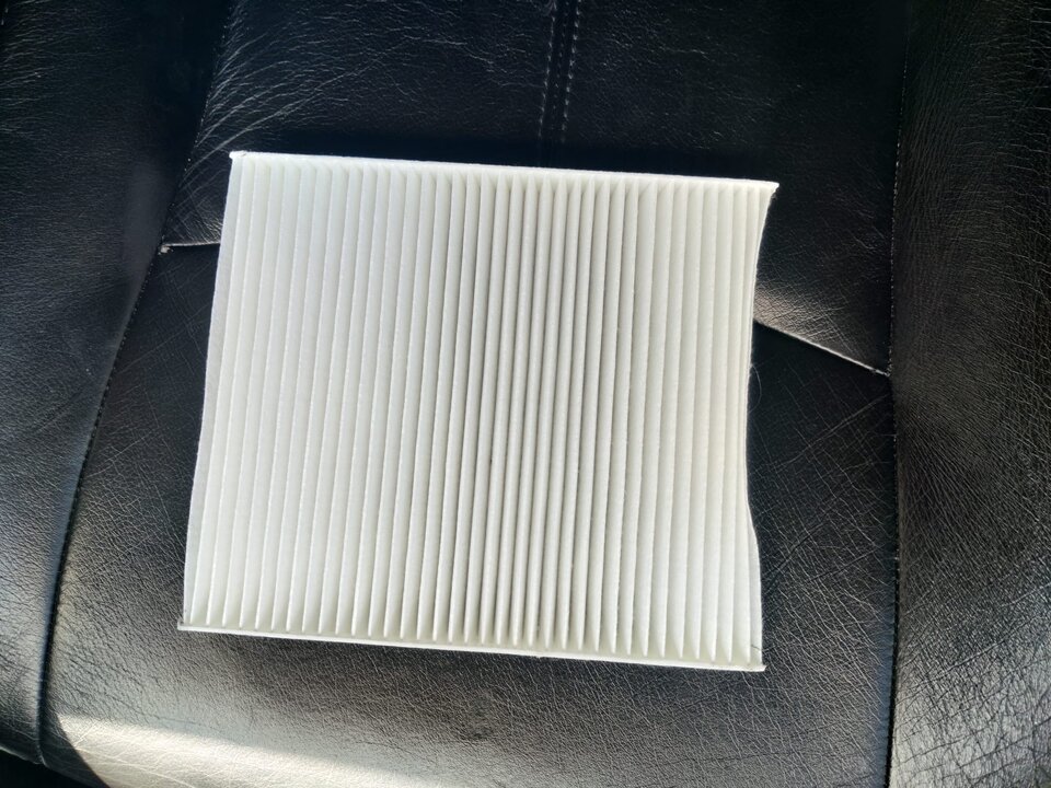

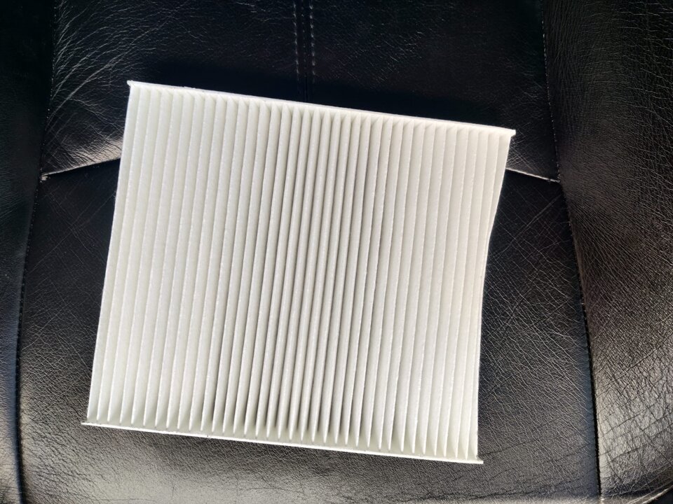

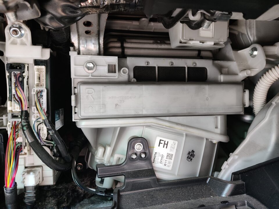

    I ordered a genuine Toyota air filter and cabin filter.
    Weirdly the cabin filter has no UP arrow/indication? Is that normal? I just placed it with the text on the filter being readable (not upside down).

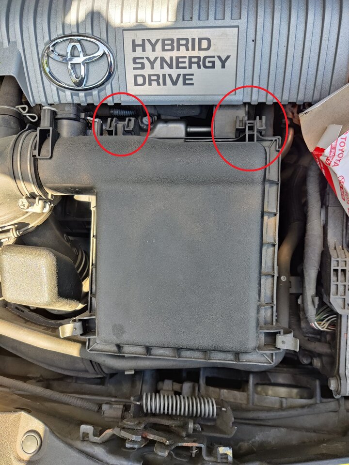

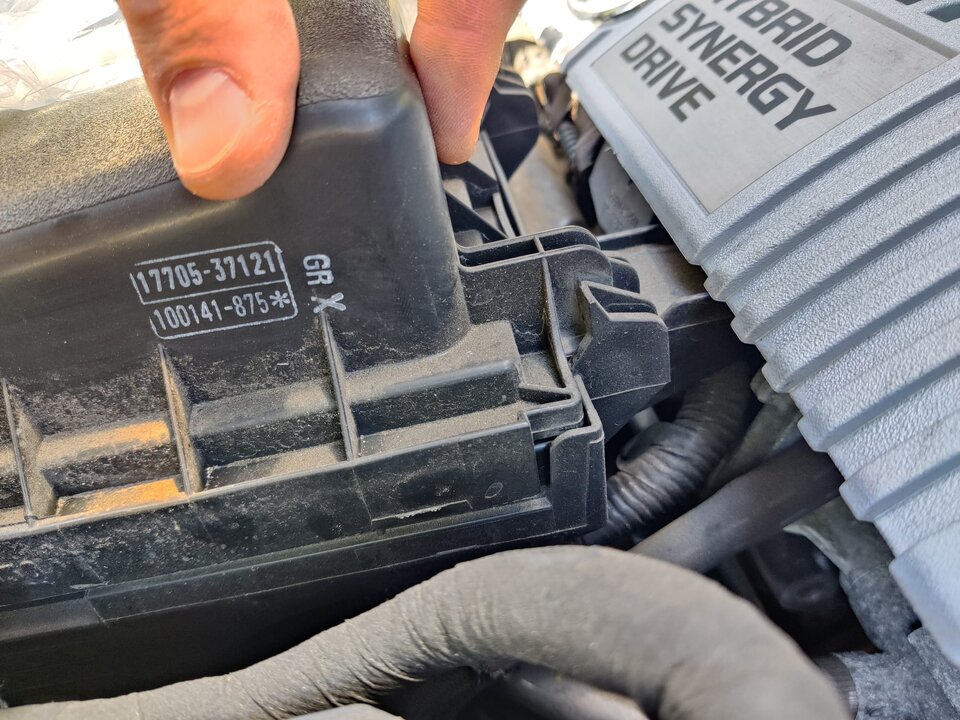

    Also are there meant to be any top clips for the air filter housing? There is very little movement on the top side, would of assumed it would have clips even though it technically slots under the plastic.
    Thanks.

    The air filter only goes in one way, for the top to fit correctly.
    And there are no clips for the back, the top hooks under the bottom. You slide them in at
    an angle. It won't be super hard to fit the top, but it will be snug. Or should be...

    Slide in no clips they're. Pleats go down gasket up if ya will.

    Unfortunately what's pictured in the original part of the post is the air filter housing on a gen 3 engine and the slide in locators in the back and the clips in the front and I guess if you put the air filter upside down and it doesn't look right to you then maybe not changing the air filter might be in the cards or something the pleats go down the gasket is up at the top when you drop it in the hole if that makes any kind of sense

    There's no clips on the back of the airfilter housing /
    It just 'hooks' in /

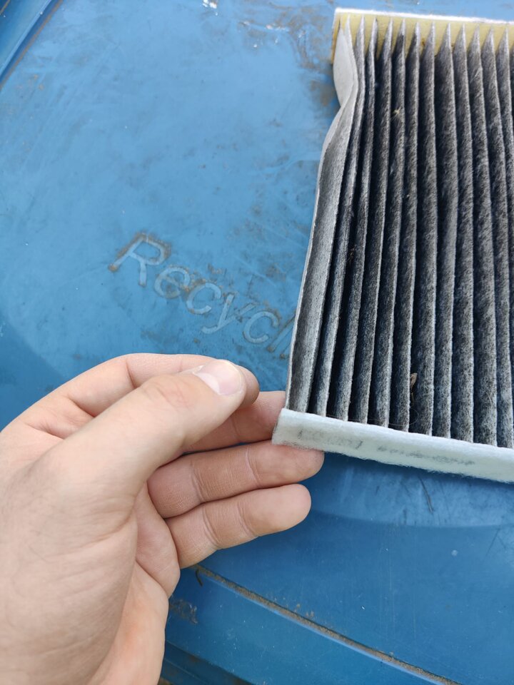

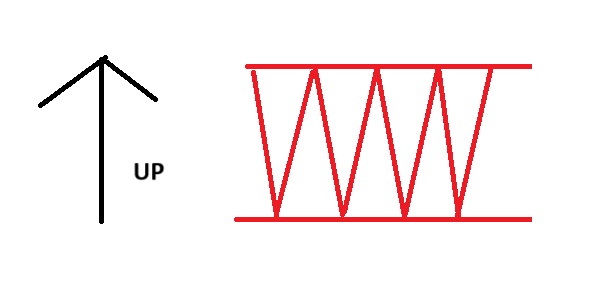

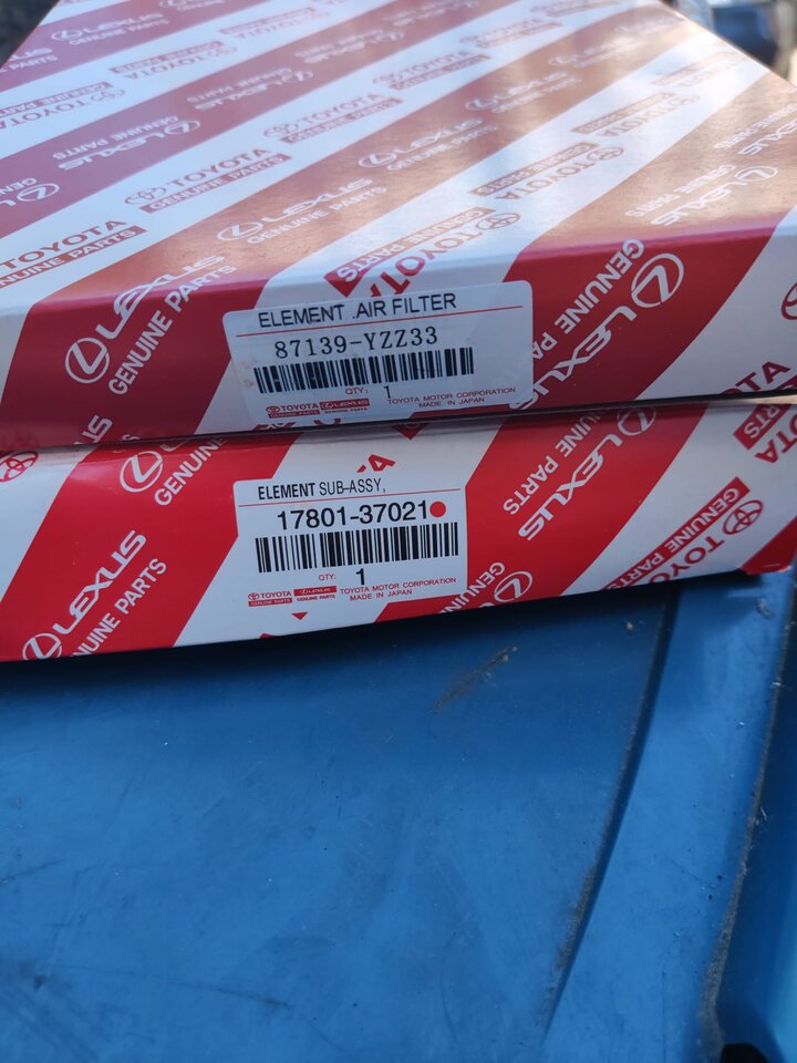

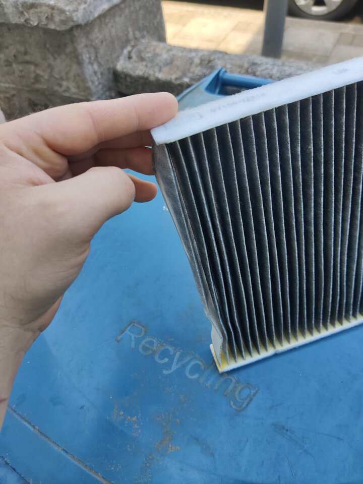

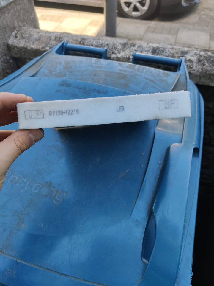

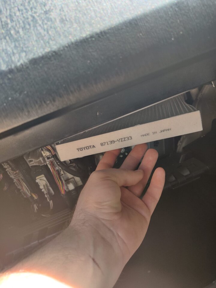

    Don't think they are counterfeit allegedly some don't have a directional arrow but I've never seen one before in person. Was bought as a 'service kit' air filter, cabin filter, oil filter and oil washer. Everything is fine/matches except the arrow on the cabin filter/direction.
    I actually checked the old cabin filter which has an arrow indication and was able to figure out what way the filter SHOULD go if it doesn't specify the direction on the new one you can tell by the way the fabric/'seams' start to bend if that makes sense. Included a picture illustration the first "opening" i.e. beginning of the zigzag should be upwards.
    Was more so interested in the cabin filter orientation as the air filter only can fit one way due to the rubber lip they have.
    Included images of the old cabin filter, new cabin filter, part numbers on the packaging and also illustration.

  11. Mendel Leisk
    61,558
    42,355
    This is nailed!

    If the one you pulled out, was inserted so you can read the writing right side up,
    that's how you put the new one in.
