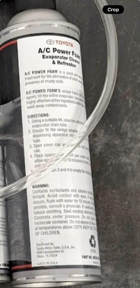

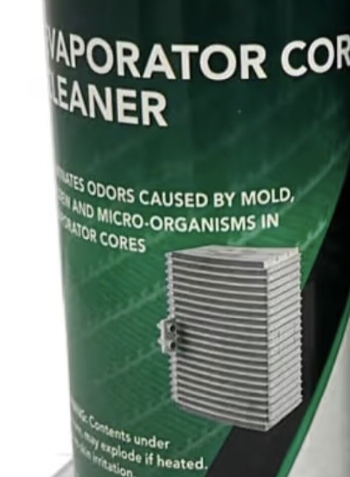

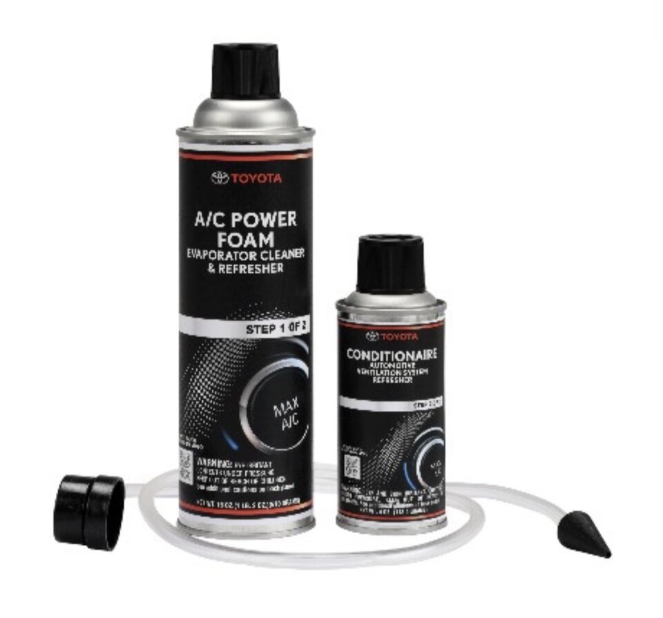

    Use an evaporator foam cleaner injected into the condensate drain. It is made to clear up mold. IMG_1082.jpeg IMG_1086.jpeg IMG_1085.jpeg

    Mold and mildew can grow on the indoor coil and is removed with specialized coil cleaner foam described above. It is effective and does not require direct access to the indoor coil.

    Mold... certainly possible this is the cause of said illness.
    You can try the Toyota products listed in post 8.
    BG products also make a similar product.
    That service is the first step :)
    You can do this "service" DIY, I have before, yet found that once
    may not be enough. Do a second service a week later.
