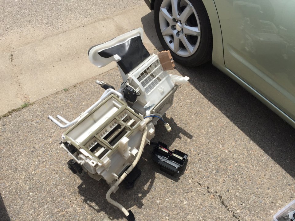

    Looks like a condenser. Anyway, that piece looks like it was pulled out of the evaporator core, which on the Prius is a big plastic shell buried in the dash, the left piece in this picture:
    Not sure how one would obtain a similar view easily. It is still pretty covered up even after it is out of the dash if it is still in the core.
