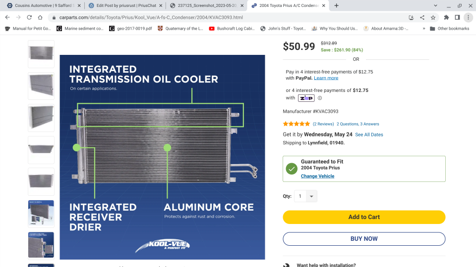

    Ended up going to dealer to access problem. Dealer I chose wanted a reasonable $50 to take a look (others in area wanted $150). Verdict: need a new condenser. Dealer wants $1300 for that. I bought one online for $50 (reg $312.89)....and am having non dealer mechanic install for $500. So saving $750. being a 2004, I'll accept risk re possible sub standard parts.
