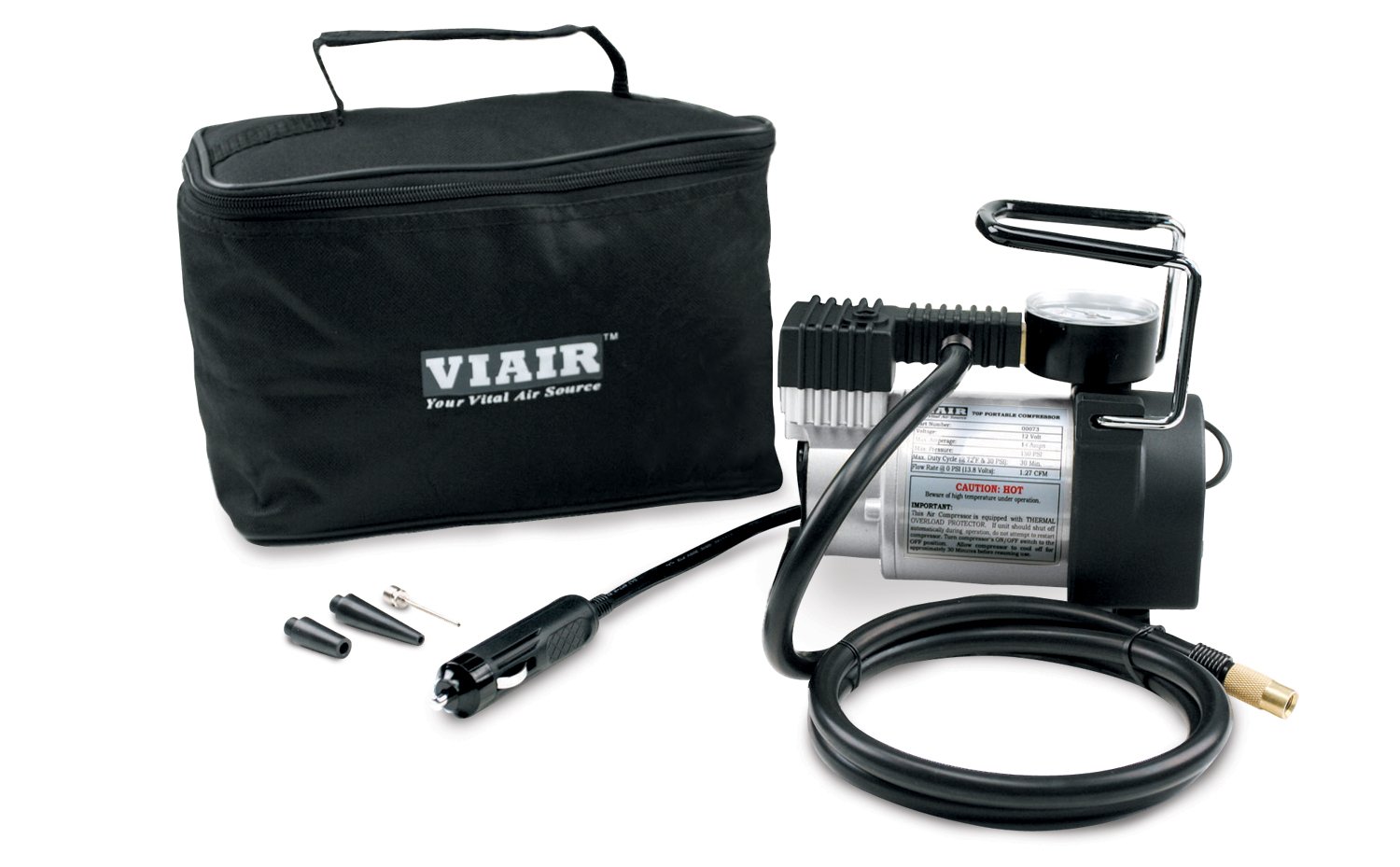

    2. Should I be concerned about using a cigarette lighter air compressor pump, such as this one, the ViAir 85P?
    It requires a 15 AMP / 180 Volt cigarette lighter connection, and recommends running the engine while in use. But I'm concerned about taxing/damaging my Prius's batteries (both the hybrid and 12V battery). Or would this be ok for use in my Prius?

    A 12v pump won't hurt your batteries so long as you use it with the Car in ready mode. My old work Prius sat for hours powering my laptop (mobile office), a pump might run for 5 to ten minutes maximum. Save the calories, use the pump & don't sweat it.

    I use a 12V pump similar to the ViAir you listed with the car in READY mode. No problems for me. It takes a little while, but it's worth it to me to avoid the gas station pumps.

    Assuming it won't harm the Prius batteries IN ANY WAY - and I need to be 100% sure it wouldn't - I think the ViAir 70P is a good solution in my case. What's the main difference between the 70p and the newer 85p, btw? They seem quite similar.

    I have been using a 12V pump with the start button in accessory mode. Is this bad? When you say in ready do you mean apply the brake like you're starting the car or just in "ready" without pressing the brake? Anyone?
  16. bisco
    115,472
    52,863
    accessory mode doesn't allow the 12 volt to be charged. you risk damaging the 12v by drawing it down too far. under the wrong circumstances, it might not be able to start the car.
    yes, step on brake push button once. the 'ready' light will come on, the engine will run if needed, everyone is happy.

    Are the Prius Gen2 cigarette lighters rated for 15 Amps? (Which is what the Vivair 70p and 85p requires).
    And, if used as described above in Ready Mode, there should be zero negative effect on either the hybrid or 12v battery, or the rest of the Prius's system health, arising from the use of these 12v pumps?
  19. bisco
    115,472
    52,863
    no harm, if it draws too much you'll blow the fuse. even toyota is now including 12 volt air pumps instead of spare tyres in some models.

    When I use the outlet with my thermoelectric cooler, the connector gets very warm and that is at 4 amps.
