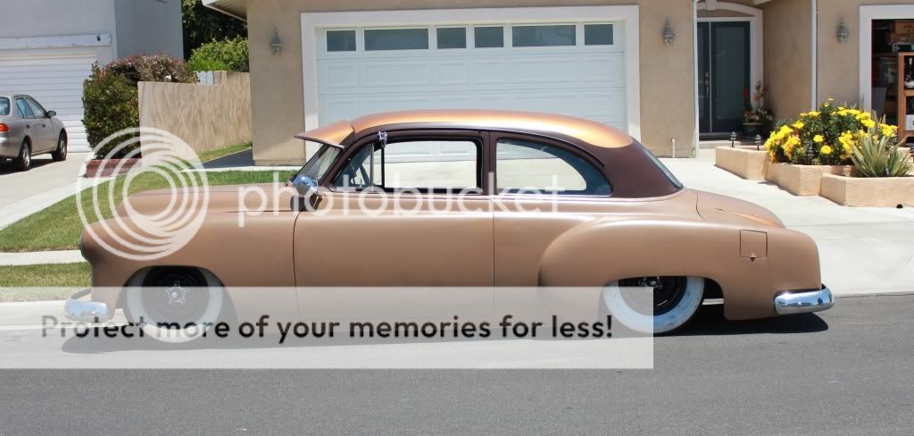

    There is a company in SO-Cal called Universal Air Suspension. They make a "universal" bag that goes over a coilover setup. Theoretically you can install coil overs on a Prius and put these bags on them to get a fully adjustable air suspension.
    I have bagged several cars and while it is alot of fun to be able to lay your car on teh ground, the ride quality does suffer.
    Here is a pic of my hobby car. At full drop, the frame is 1/4 inch off the ground. I am able to drive it fully dropped on smooth roads.

    I cannot wait to see photos of your slammed ride! I would love to do the same on mine!!@:rockon:
