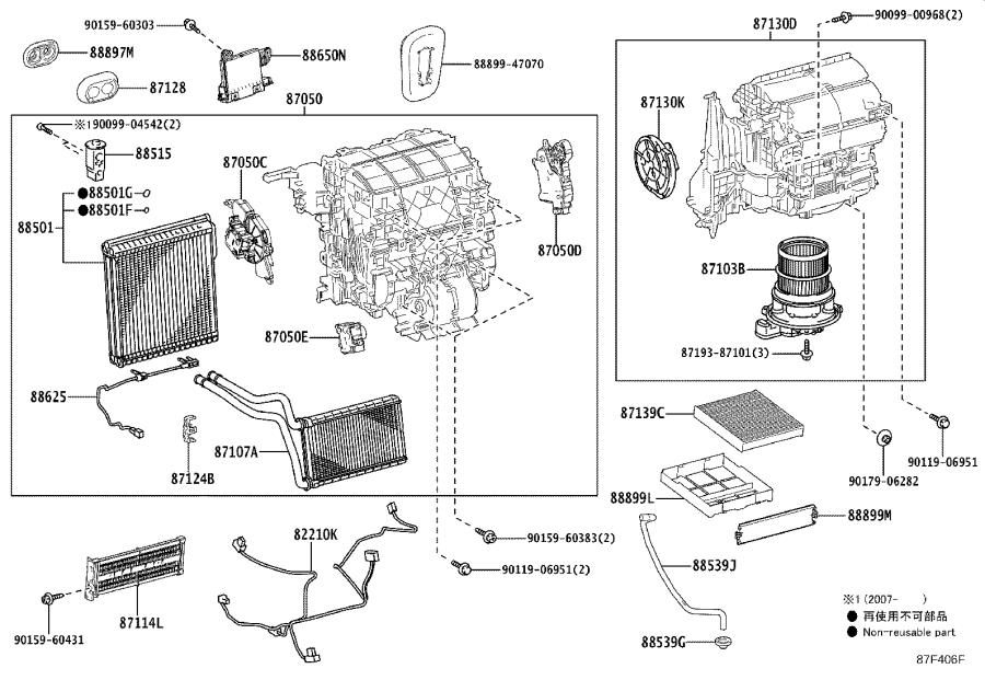

  8. ChapmanF
    28,743
    19,041
    This at least shows where the system's four servos are. They are callouts 87050C, D, and E, and 87130K.
    I could take a guess at which one is the "FACE servo (passenger side)", but I don't have a Gen 4 repair manual to look at (Toyota Service Information and Where To Find It | PriusChat), so you'd be ill-advised to trust my guess.
  9. Elektroingenieur
    Elektroingenieur Senior Member
    Jan 8, 2017
    2,515
    3,288
    Three Touring
    That illustration applies to left-hand drive models. On @AdeelUK's car, which I assume is a right-hand drive model built for sale in the U.K., the arrangement is different, with the blower assembly on the opposite side of the air conditioner.
    See the B1448/48 diagnostic procedure in the Repair Manual available by subscription to toyota-tech.eu. The edition published there, unlike those available in the U.S., includes the text and illustrations for RHD models, which have different designations for the servo sub-assemblies.
  10. ChapmanF
    28,743
    19,041
    Oops, thanks for the catch.
