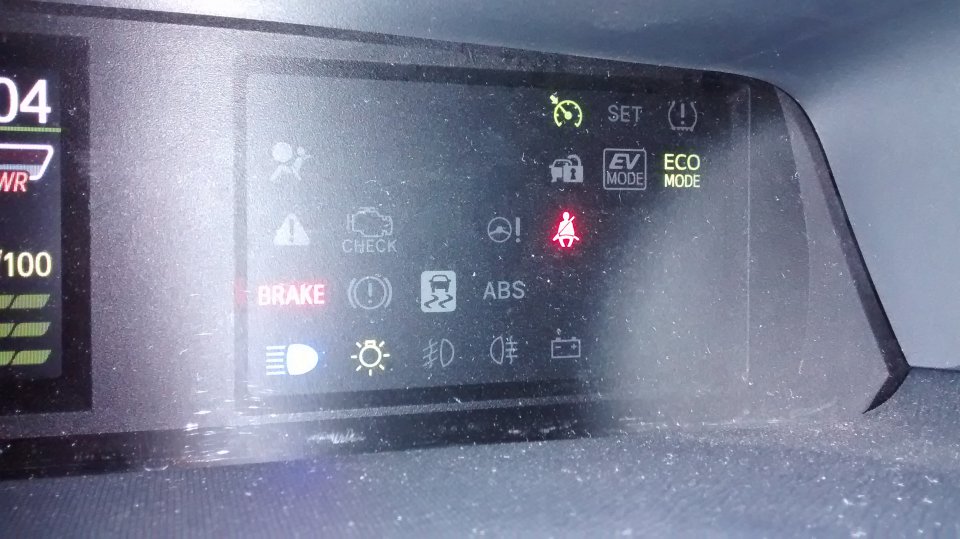

    The tape is on! Now we might be able to unlearn the habit of ignoring that side of the display..
    A little strip of red electrical tape. It cuts out about 95% of the yellow light emission..
    Now it's down to less than 25 lumen.
    Hey, now we can drive at night, without sun glasses!! :)

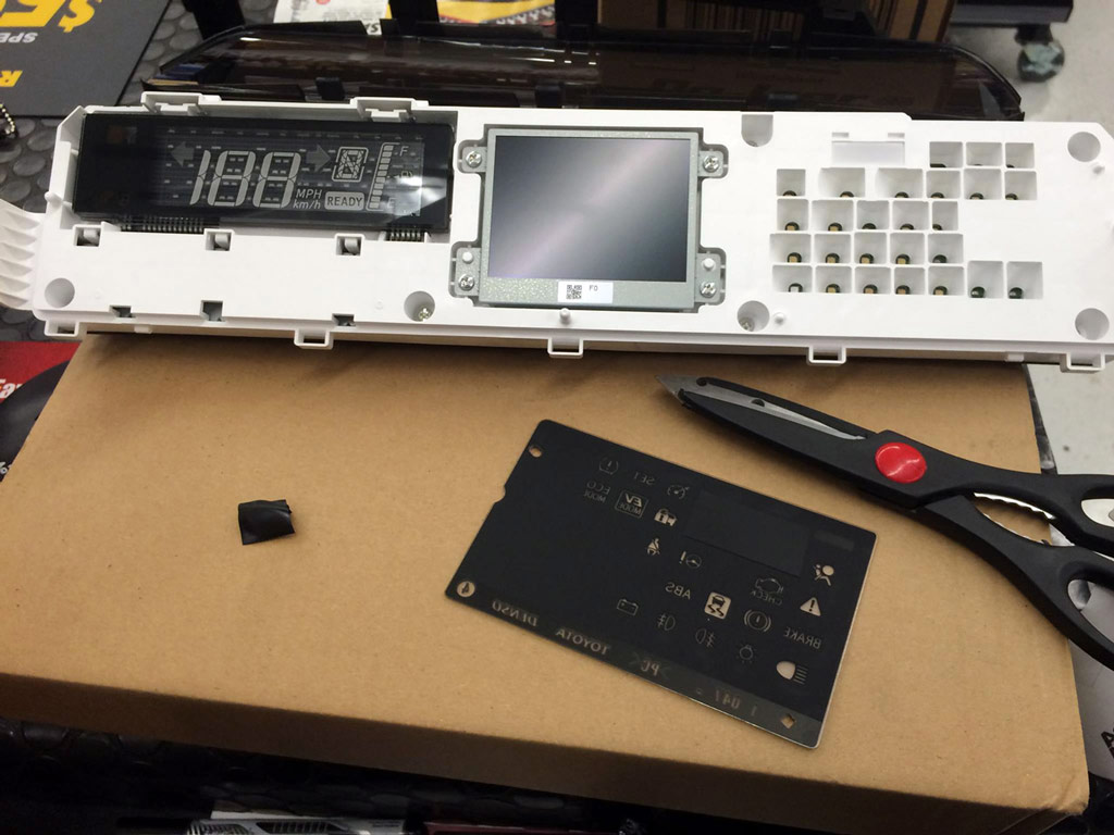

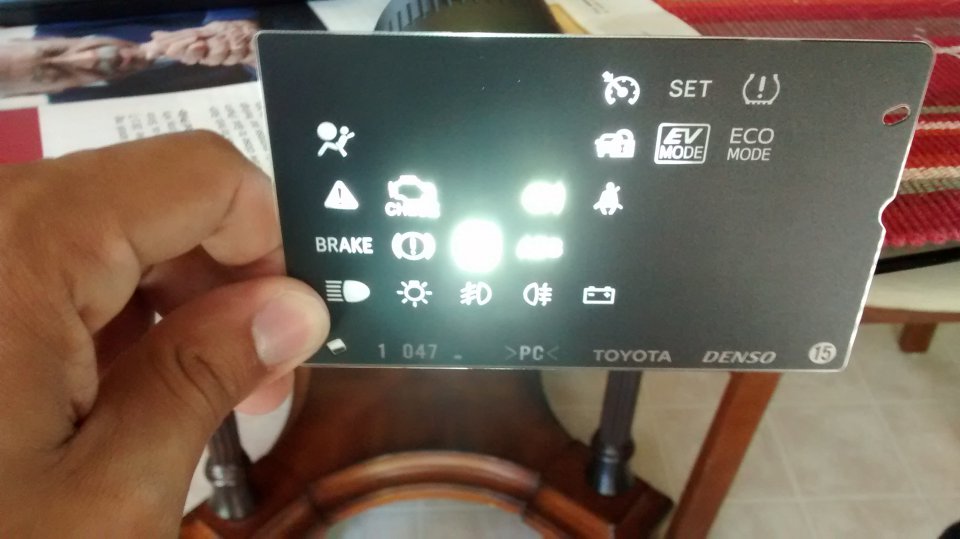

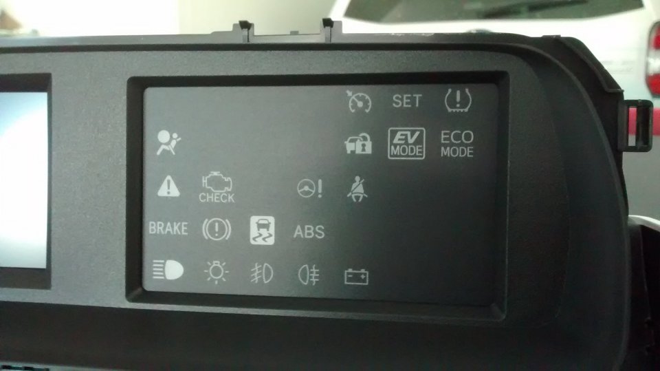

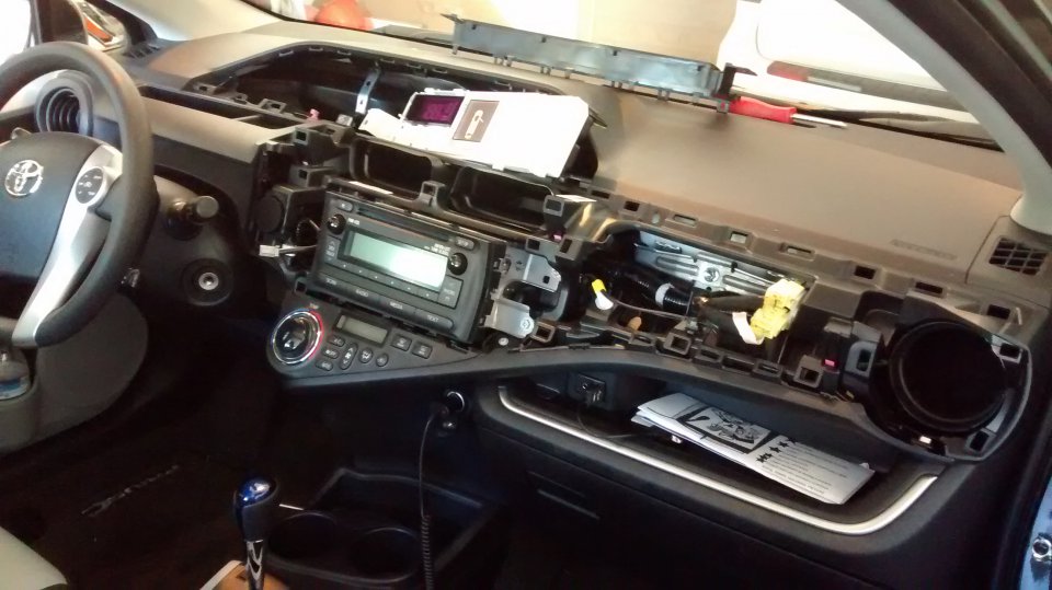

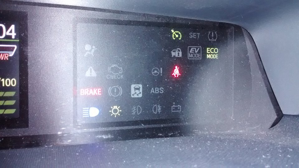

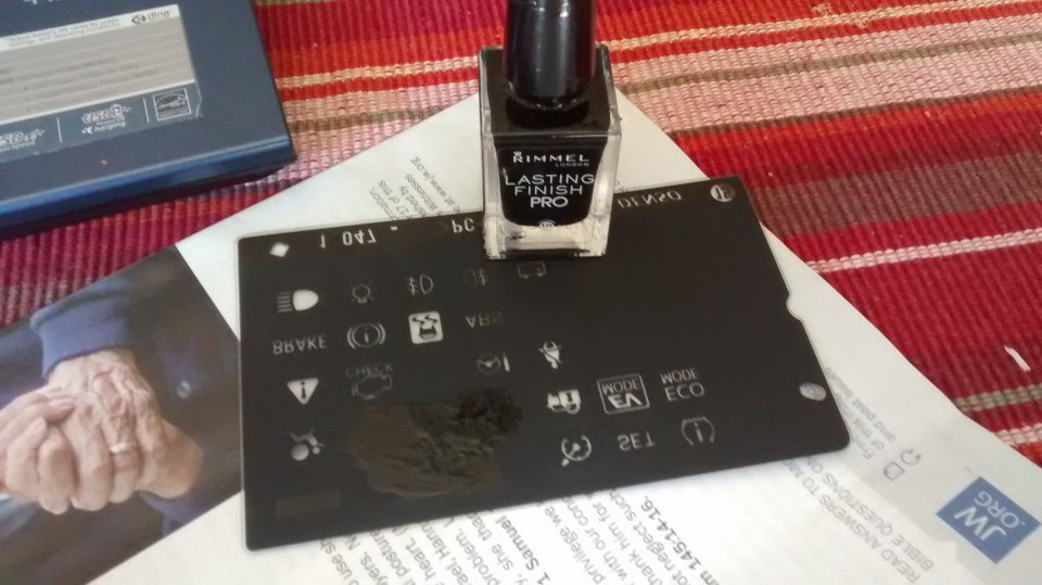

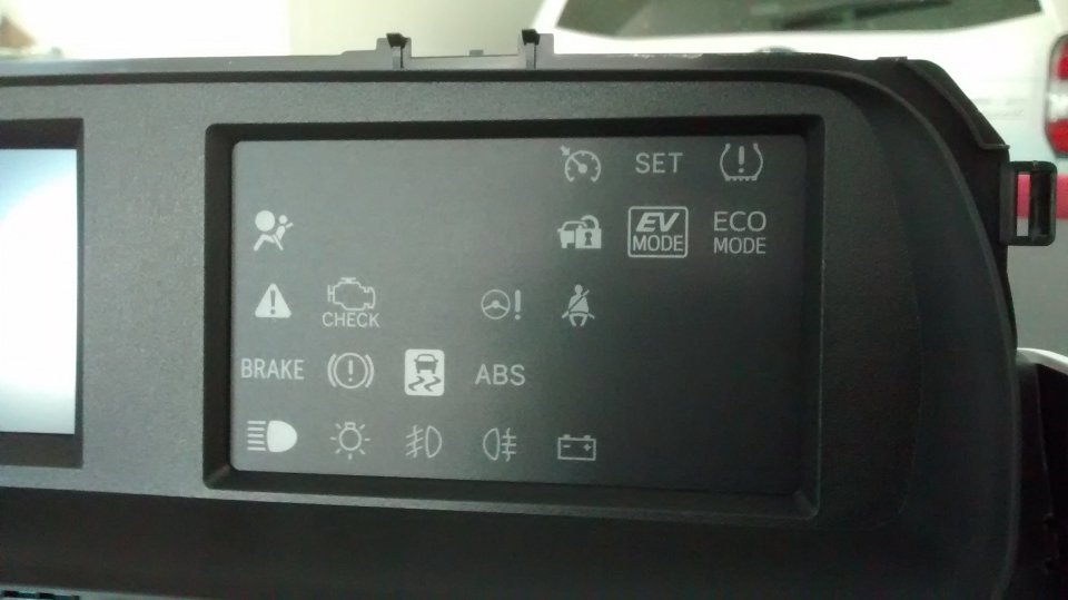

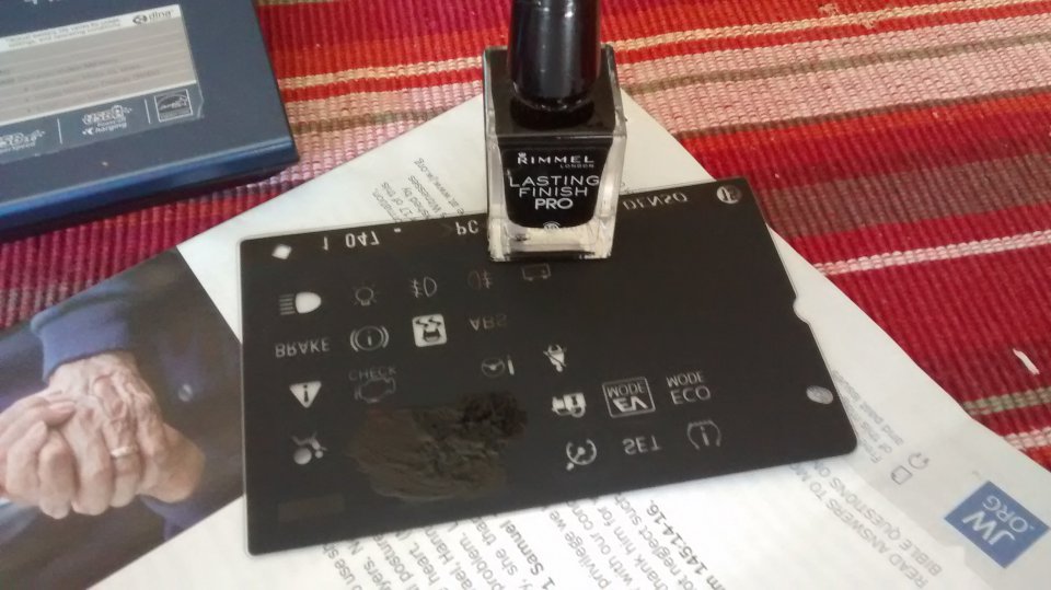

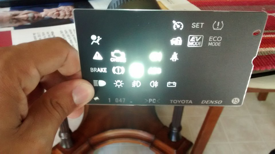

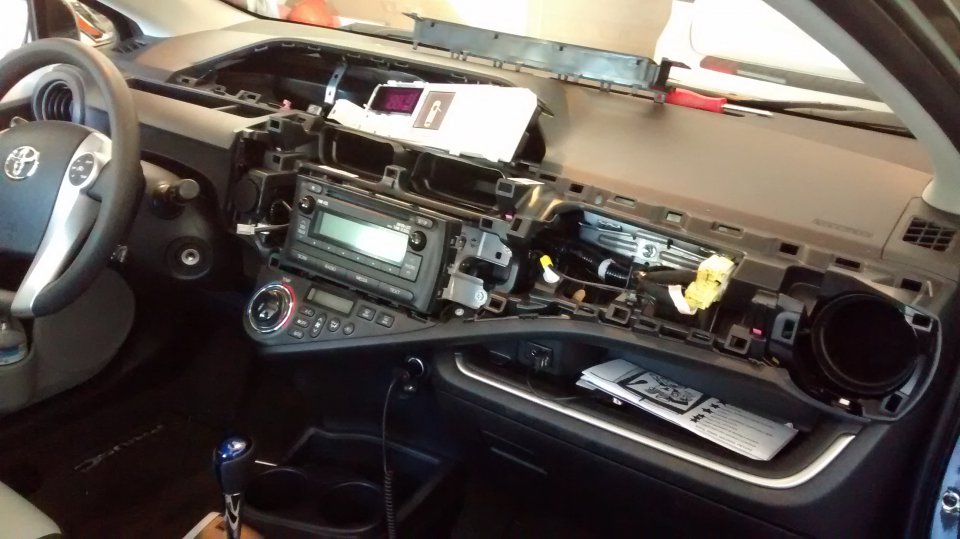

    I took the cluster out, and used electrical tape to block off the lights. I tinted some of the others with 20% window tint (not shown) - I tinted the Eco mode light, the cruise control lights and the headlights on indicator.

    surprisingly i now find the green sunshine headlamps on indicator to be very useful. strangely enough, the blue brights on indicator light goes on when itz just the parking lights that are on and of course the high beams arent actually on.,,, because only the parking lights are on,,, confusing.
    awesome amount of work ,,, thank you

    They're just indicator lights. Some more purposeful, some more-or-less pointless. But tearing open your dash to cover them up??
