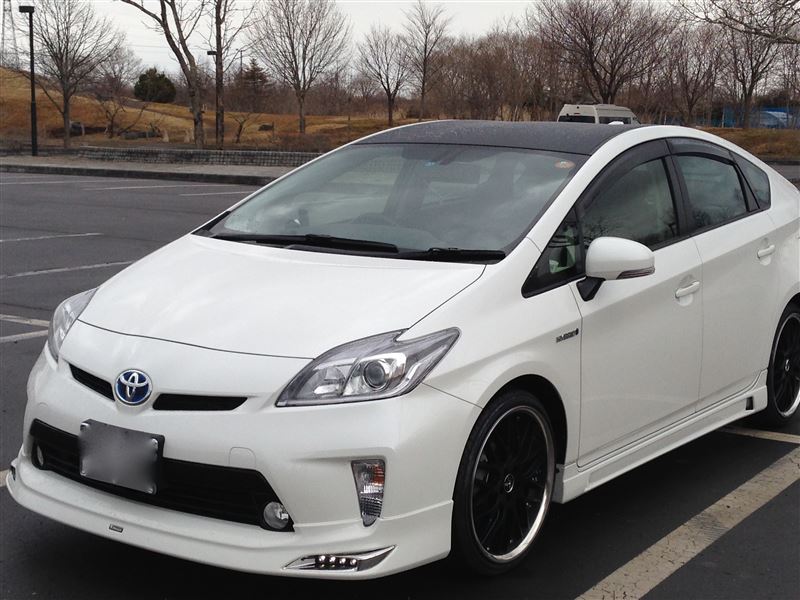

    Hahaha! Not my car :(

    So that is LEDs in the front huh? Have u found a pic of the rear RightOnTime?
