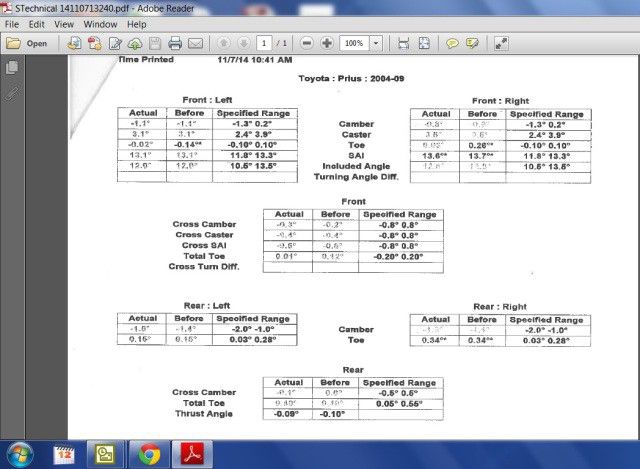

    Did I just get ripped off?
    I had a coupon for $79.95 for a 4-wheel alignment, which included a tire rotation. I noticed my tires were wearing unevenly (specifically the fronts) and my steering wheel was off-centered. But, looking at the numbers, it looks like they only adjusted the toe.
    Im thinking, in a perfect world, I should've paid for a front end alignment and not a 4-wheel one. Just sayin'

    you can't adjust the rear wheels on a prius. if there is an issue, you have to go to a specialty shop that can install shim kits. the dealer isn't even going to look at them. that's probably a generic coupon for all cars. they do the same thing with the 12 volt battery, then when you show up in a prius, they're like, oh no, it doesn't apply to the prius battery.

    Its 4-wheel alignment if they check all 4 wheels. Rear ones on Prius (and many other modern cars) are only adjustable by replacing rear axle. Or using shims witch manufacturer is against.

    that would be a front end alignment, and a rear end inspection.:p

    I want to add that my steering wheel was off center from when the dealer performed the steering bolt recall - I brought it back twice and they tried to straighten it out each time, but the wheel was still 5-10 degrees off center to the right. :mad:
    OH, and one more thing - do any of those numbers look out of whack or is my Prius in pretty good shape still? I ask because Ive heard about the shims, etc.
