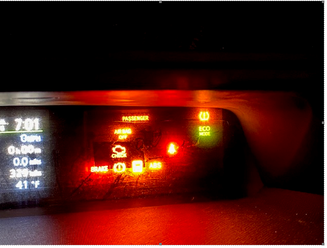

    Most of all of my dashboard warning lights now appear. ABS / Traction Control / Break / Engine / Tire Pressure
    I've tried resetting them by disconnecting the battery, connected pins pin 4 and 13 and it made no difference.
    tried clearing DTC codes through reader and made no difference... Not sure what to do
  2. America First
    America First New Member
    Mar 19, 2020
    pa
    2014 Prius c
    note: I spilled coffee on center console buttons for economy and ETC, the lights came on after
    error: P0113 Intake air temperature sensor

    Well if that happened, maybe something shorted out.
  4. bisco
    115,300
    52,765
    maybe it will be okay after it dries in a few days

    Most likely, we will have to wait for it to dry out and see.

    Mine just happened this morning but I can't do the pin thing because I'm missing the female part of the obd2. Did yours ever resolve
  7. ChapmanF
    28,615
    18,949
    That's pretty much the way the connector in my car looks. Are you calling it unfeminine?
    If you do "the pin thing", please be one of the smart ones who use it to find out what their trouble codes are. Then you can post those here.
