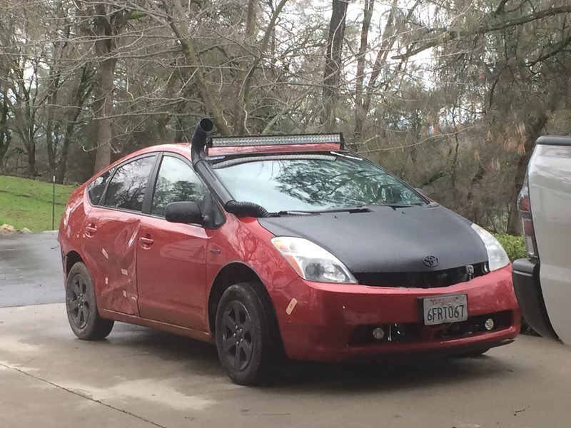

    For what I imagine they charge, you'd think they could at least throw in a snorkel:

    Put a roof basket on that with a ATV spare and a few cans of gas and you've got prime /r/battlecars material.
