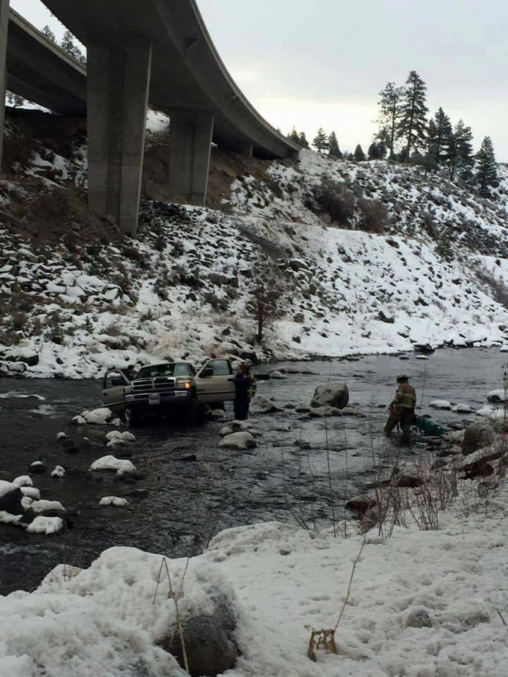

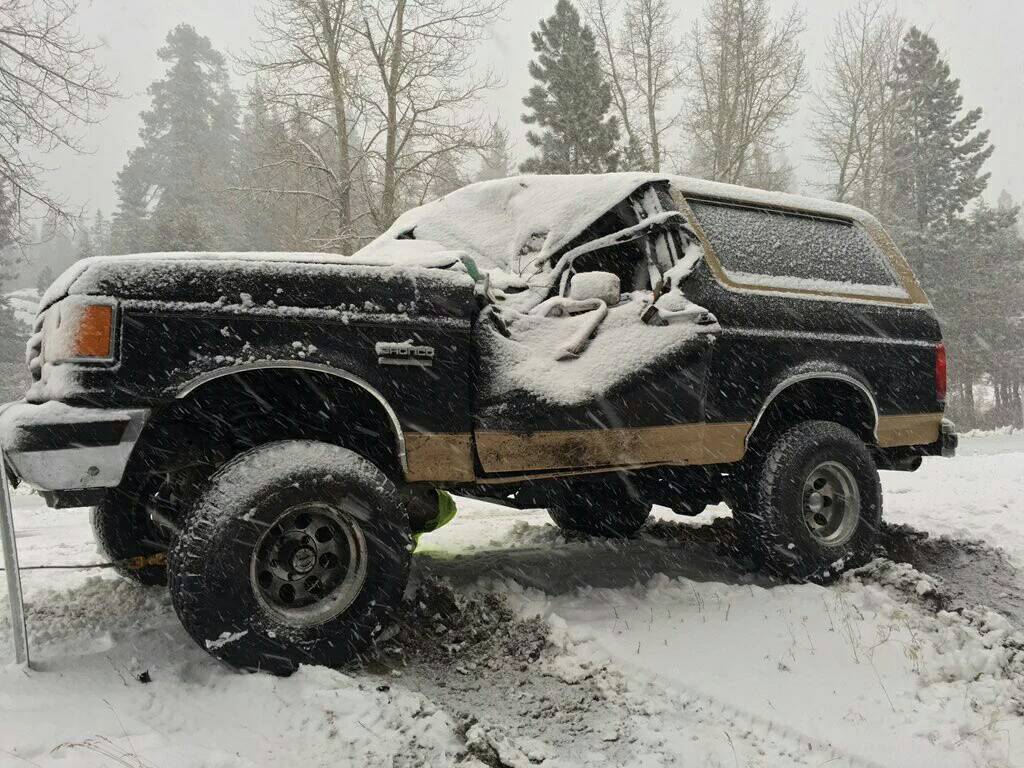

    I see this all too often. [​IMG][​IMG]
    The Rav4 AWD does have a center lock button to lock it 50/50 front to rear. Our CRV does not and the rear differential isn't strong enough to drive the car on its own anyway for more than a few feet
