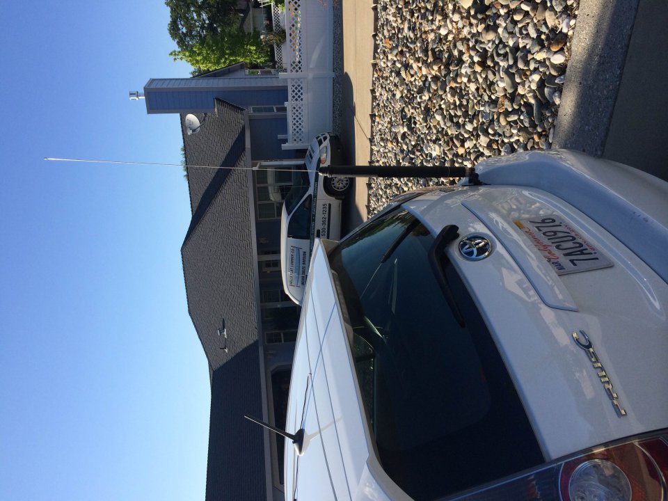

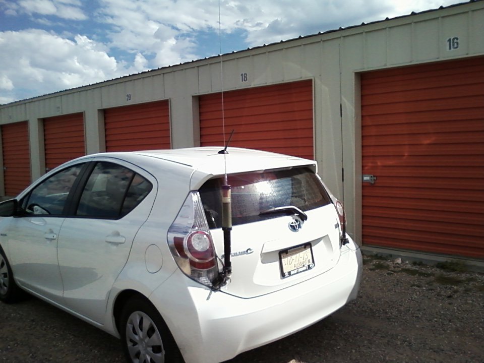

    Here it is with the two new antennae.
    I have more work to do for the permanent install.

    Geeze, that;s a loading coil! Are you using a K-400 mount on that thing? I have to wonder how good a RF ground the back hatch has, and does it conduct enough? Or do you then go the extra step and grab some braid shield from a chunk of RG-8 and physically ground the tail to the car. What kind of SWR are you getting with SWR Autotune off?

    That's my next step tomorrow.
    I'll dig out the MFJ SWR meter and have it a go.
    First indications are not looking good for SWR.
    I had the same installation on my Saturn VUE. I just installed the mount and everything was good.
    The Toyota has a better/thicker paint job so I think that extra grounding is needed.
    I'll keep in touch.
    PS: Remember that the Little Tarhell II screwdriver antenna tunes 6 Meters through 80 meters. Usually with a SWR of 1.1/1. once tuned/bounded it should never rise above 1.5/1. When I add a special extension adapter it will tune 10 meters through 160 meters. I think it is a small coil to be able to do that. Ever seen a Hi-Sierra coil? Now those look huge even on a 1 ton pickup truck.
    The mount is a Comet mount. Almost identical to the K-400.
    Remember that screwdriver antennas do not use a R/C tuner like most antenna setups. They actually adjust the length of the antenna so it is in resonance. Hence no need for a R/C tuner.
    Once the antenna is adjusted for length it is 100% resonant. The R/C tuner would not be able to do anything to help the tune.
    I also use a "Turbo Tuner" that senesces the SWR of the antenna for its current frequency and adjust the length of the antenna for a resonant tune. All this is done by one button push on the radio. Safest thing going as you never have to look at the radio just fell for the button and press it once.
    John
    KW7A

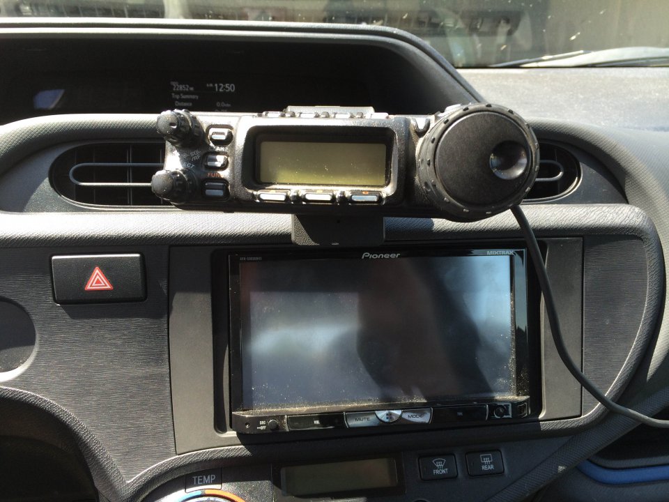

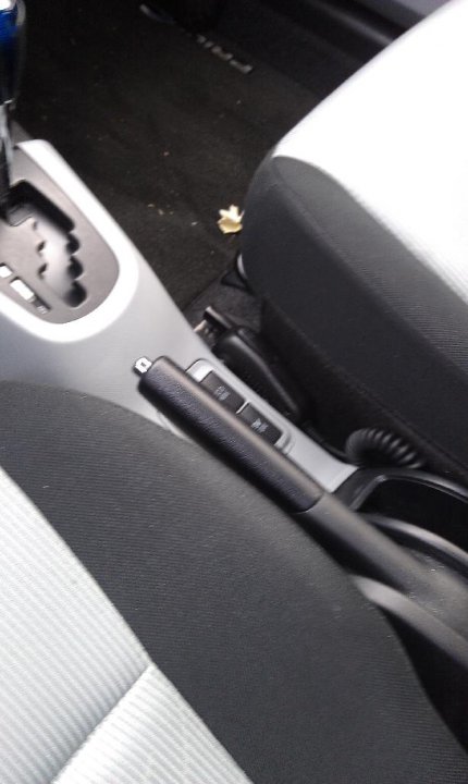

    W5JCK here. I have a simple, non-destructive installation for my Yaesu FT-7800R. I did not want to drill any holes are run a power cable to either battery. Using a magnet mount for the antenna and a Lido mount for the radio head, I was able to mount the radio/antenna in about 30 minutes. It was easy to hide most of the cables. The radio body is mounted under the front passenger seat with at least 1" of airspace all around for cooling. I use the rig mostly for Skywarn RACES spotter activity in Tarrant County, TX.

    Quite a few of the Yaesu's have detachable control heads. I have the FT-78oo in my 2012 C-2.

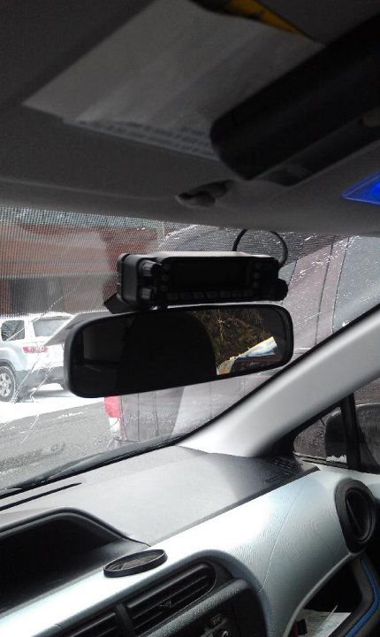

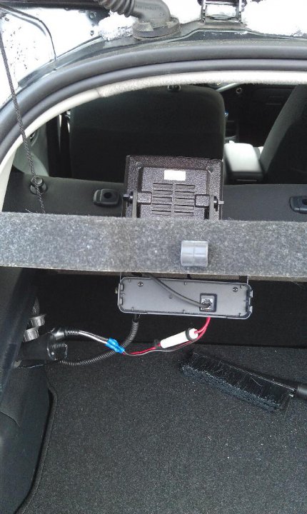

    This is what I did with mine...
    Motorola speaker FT 7800 mounted to rear.jpg microphone prius.jpg Control head above the mirror.jpg 800mhz scanner antenna.jpg 2m 440 antenna.jpg

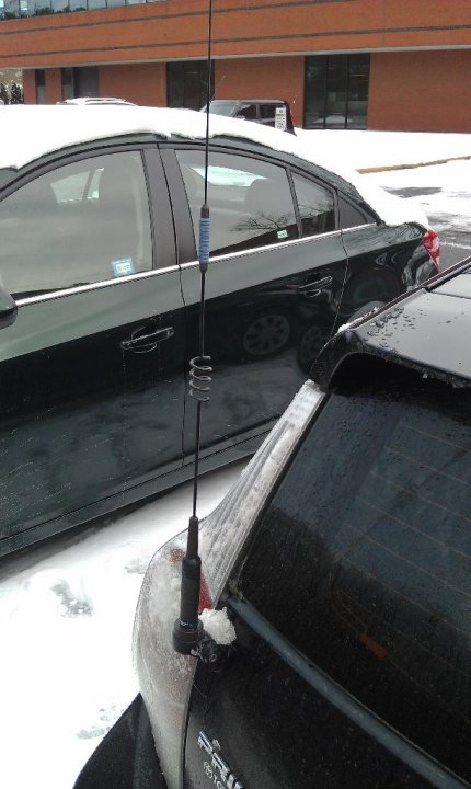

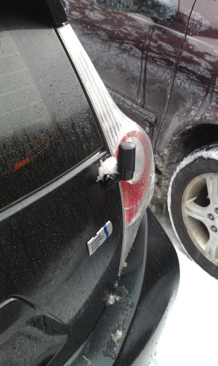

    Hey gang. Figured I'd go ahead and post up on here. I just "inherited" my wife's Prius C after I got her an Acura RDX. I figured it was high time I install a decent radio in this thing since I'll be commuting 2 hours a day in it.
    I wound up installing an FT-857D with an ATAS 120A on a K400 hatch mount. I also threw a small "hershey kiss" mag mount up on the roof for VFH/UHF. Everything seems to be working OK at the moment, but it's definitely a bit noisier than I'd like. Going to have to chase some grounding issues I believe.

    wow - been a while since I saw the little 120A. iirc, it works down effectively to about 40 meters? Sure looks less geek-efied than the honkin' 6" coil on our screwdriver.
    But yea - grounding .... that's always a problematic thing on hf.
