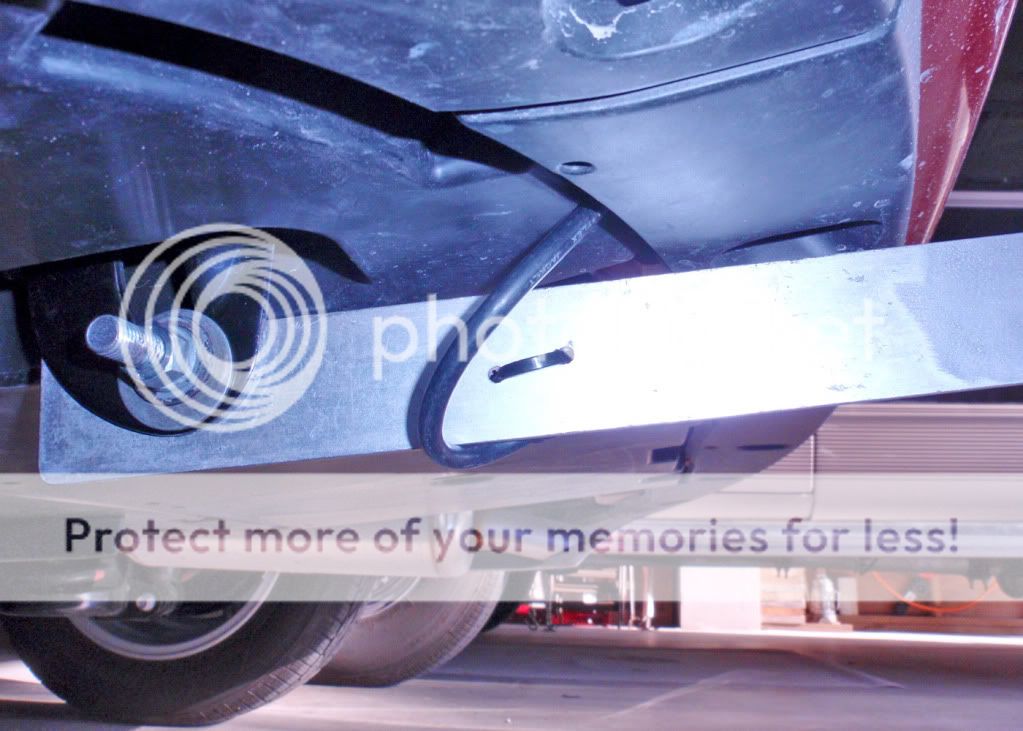

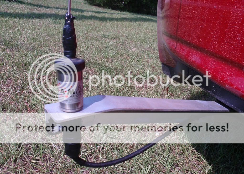

    We needed a quick (and probably temporary) 2-meter installation in our 2010 Prius. I used a piece of 1.5" x 1.5" x .125 aluminum angle about 14" long. I attached it with a 3/8" bolt and washers to the tow loop under the left rear of the vehicle. I notched, bent, and welded the joint to angle the antenna away from the back of the car so it wouldn't whip the body.
    I was able to run the coax between the plastic panels under the vehicle and through the grommet in the spare tire well. I powered the radio from the + terminal on the battery and the screw that secures the bottom of the battery tie-down. Each wire of the power feed cable is fused. The radio sits in the center tray under the console. Not pretty... but it works.
    N1VE
