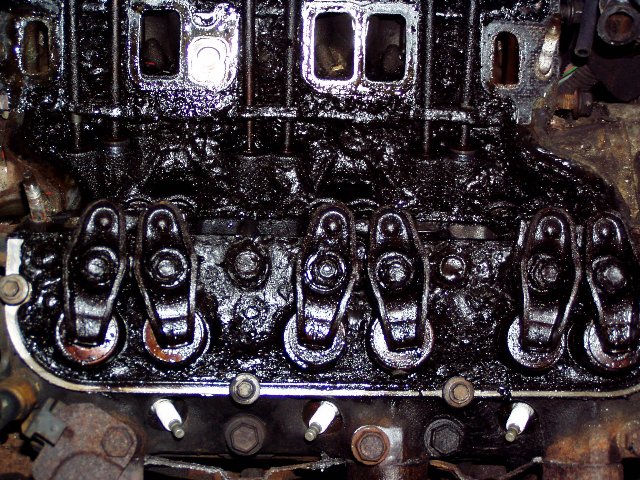

    WRONG! I'm a failure analysis inspector and I see the damage from carbonized oil on a regular basis.
    This is why I said to change the oil every 3K. The detergents in the oil will help remove the canonization
    in a slow process that might enable the filter to help catch it. Changing it will drain out the junk that gets
    loose and circulates into the oiling system. Filters are much better, but they can only do so much.

    Yeah! You must not understand,English either. Carbonized oil has nothing to do with Soot.

    BTW, thanks for the picture. That helps. At least I know you are talking about oil sludge aka oil gelling. I doubt the OP has this problem.

    Type O :p Now do you understand what Carbonized oil is ??? :LOL:
