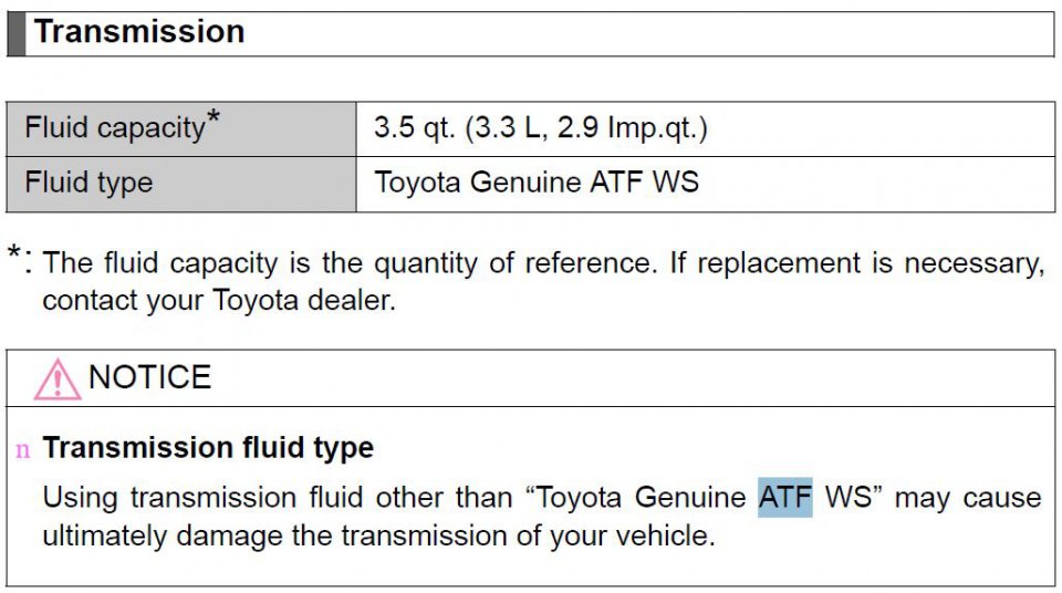

    Searching my pdf of the US/Canadian Owners Manual, this is all I can find on the subject:
    The grammar of the last sentence is a little mangled, but I think the message is clear.
    I also searched my pdf of the Repair Manual, and found no spec for the transaxle fluid, just generic description. There is typically a little blue icon beside the generic description, saying INFO. I believe it's some sort of link, but it's broken in my pdf.
