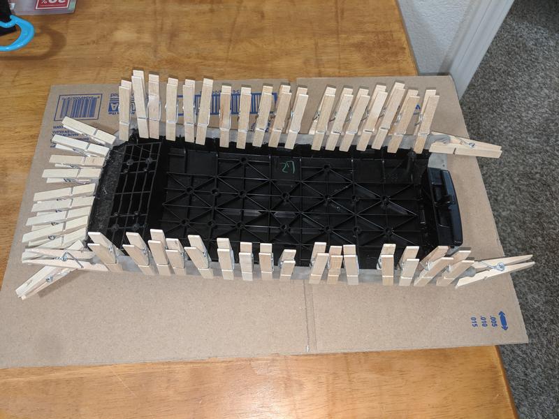

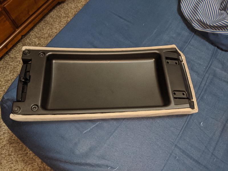

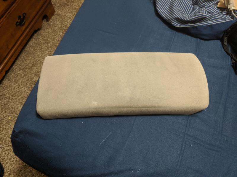

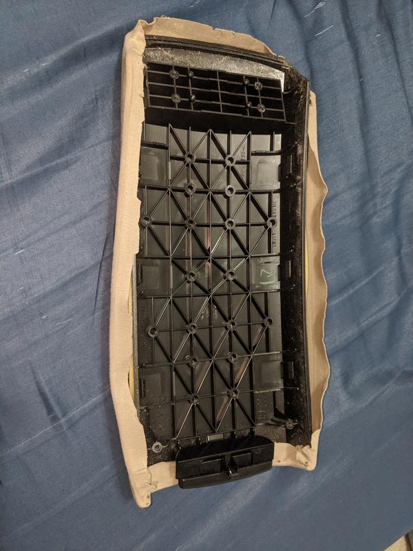

    Moving on, the fabric on the center console lid was coming unglued. Looked on eBay for another used lid. Ran into the same problem as I did with my Nissan SUV..people on eBay think center console lids (just the lid!) are worth their weight in gold.
    $116 for a USED one? No thanks!
    So I took the fabric apart further and used some Goop (actual brand of glue) and a million clothespins to hold the fabric in place for a few hours then put it back together. It's not perfect, but it is a lot better than it was.
    dolj likes this.
  2. dolj
    dolj Senior Member
    May 14, 2012
    8,652
    4,401
    Wellington, New Zealand
    Nice work on both endeavours. I think the centre console lid came out looking good.
