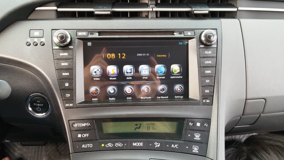

    Hey guys..finally got my radio and installed it..everything matches oem of the car decor. It works well and no problems have come up yet. I am posting the install of the unit. Here is link to place that i got it from. Smooth transaction , product built in week and shipped in about 3 days. Dealt with Joyce for questions.

    How is the FM radio reception?

    The am/fm reception is good. Stock antenna . Socal location

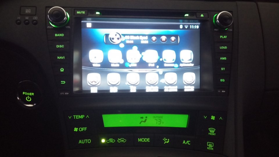

    May I ask How is the display brightness? I had an Ottonavi unit before. The brightness of the display was very bad in sunny day.

    3. Does spotify work on that unit?? I have a wifi mobile hotspot, so that's a non-issue, and spotify has an offline mode.

    You can adjust how loud u want nav over your music..screen bright but then our car is tinted..havent tried but any android app will work on this unit
