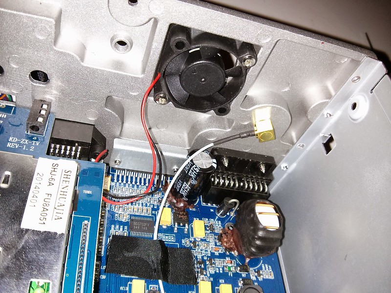

    That does look like the mic module for the radio in right corner. In front of the radio there was hole on each side of the CD slot for mic. I haven't got chance to take it apart since I don't drive the car. I haven't gotten any response either anymore from the seller. Its a bummer since it was going good up to this point. Suppose the ext mic jack works and cuts off internal but dosen't work. so when i do have time I might try unsoldering the internal mic and see if external work. Yes the fan is kinda loud but dont notice when the radio is on and you are driving. Besides these two thing the unit works very well in GPS , radio, mp3, ipod and video functions. Much better than my Myron and Davis unit which was only good for Bluetooth and radio.

    I contacted the seller about the mic issue and she said her other customers are having the same issue. I assume you guys are the other customers :)
    However she said once you plug in an external mic it cuts off the internal but that doesn't sound like the case. I am really disappointed as this is one of the basic features I'd expect to work.

    And no the external mic dose not cut off int mic

    Did you disconnect the mic module inside to see if external mic connection works? I dont have any time to take it out and try this out..

    I got an external mic and now it seems both the internal and external are working but the sound quality is no good for phone calls.
    Did you get a chance to disable your internal?
  20. Prius2012fl
    Prius2012fl Junior Member
    Mar 22, 2012
    Fl
    Update, I disabled the internal mic. I have a video the seller sent if you want to see how it is done.
