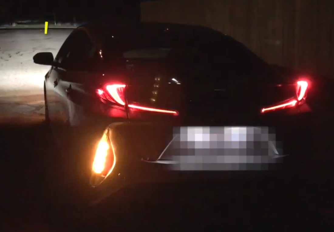

    I sure hope the distracted tailgater sees these small brake lights in time. :eek:
    Night time is good. It's during bright sunlight that the brake lights seem so small. The vertical portion that is circled, is that a reflector? I'd like to see the brake bulbs extend the full length downward. Similar to the Gen3 models.
    When driving behind one, the entire car looks very small from the rear. Probably another reason for all the tailgating.

    i need a night pic to know for sure.

    In Norway the left one is the OEM rear fog light, which US versions dont have. And the right one is just a reflector, from what i know u cant put anything in them because its just a flat reflector if that makes sense... there is no space between the reflector and the transparent cover on the US version.

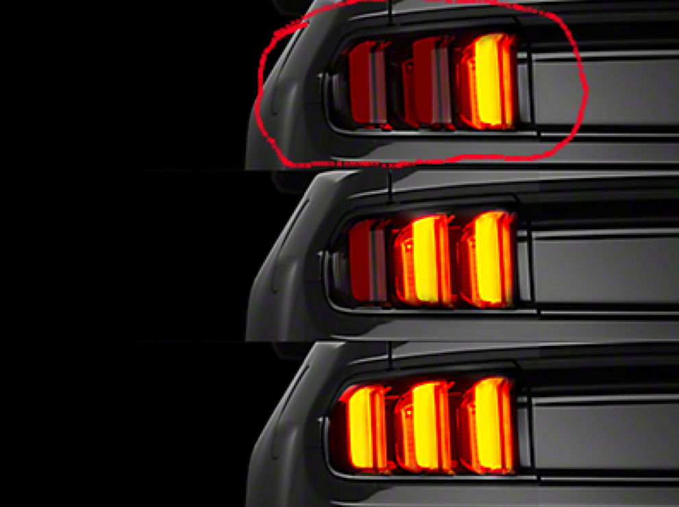

    Ford Mustang have sequential blinkers.

    That is because on the Mustang, only the inner red blinker (marked in red) is needed to meet the mandatory standard, the two other r not needed to meet the standard, theyre not even certfified as indiators, theyre just certified as exterior lighting. [​IMG]

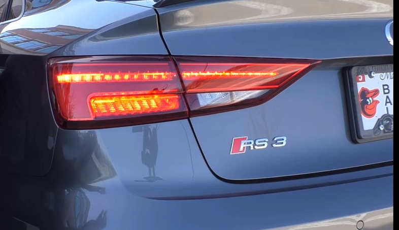

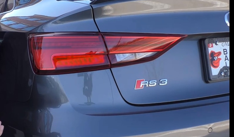

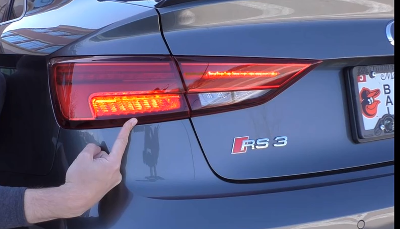

    Sequental blinkers on for example the new RS3 however, is not enough to meet the standard in USA, so they had to add an extra constant blinking indicator in the brake light underneath the sequental blinker.
