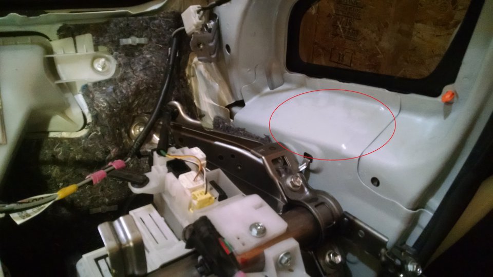

    I did saw that metal bar...but everything is super tight... To me it sounds like it is coming from under the white metal welding right under the small side window, but there is no way you can get there since it is all welded...I gave up for now, but if someone have any ideas like you I will be more than happy to hear. This is my uber Prius so that is why I can't drive without the dash.. if it was just for commuting I wouldn't care driving without the dash hoping with time and different tries eventually find it..But like I said I will tear it again for no time :p
    I think this is where the noise is coming from.

    Tried it .... did not work.. is it easy to remove the fender ? Is there anywhere a picture of the clip that gives us the trouble ?

    I'm not sure anyone has taken a picture of the defective clip - and if your noise is not a "buzzing rattle" at certain RPMs, it could be some other problem. If you can get a passenger to listen right at the A pillar while you are at RPM, it would confirm it. Short of removing the fender, which is a huge job, I don't think there's another solution. Part of the rag-stuffing method is to prevent engine noise and vibration from getting to clip. I packed rags so you could actually see them from under the hood (picture).

    I'm not really sure, but I think the clip holds the fender to the body. As to where it is exactly, I can only guess it's just below the small right front window (as you show in your diagram - circled). I just looked at the other end of that area by opening the passenger door and prodding just behind where the upper hinge meets the body. I see and was able to wiggle some piece of black plastic back there. I wonder if that is part of the problem?
