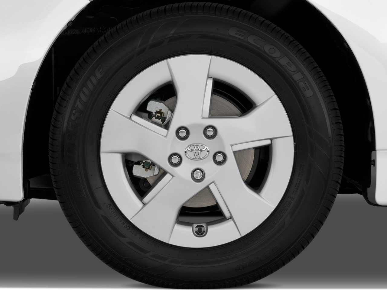

    They are aluminum with plastic inserts. Gen3 was aluminum with plastic hubcaps. Aluminum makes wheels lighter, and plastics lower drag.
    Gen3 wheel without hubcap:
    Gen3 with hubcap:
    You could probably remove those plastic inserts if you prefered the look, although nobody yet posted how those wheels look without the plastic inserts. If you try it, be sure to post some pictures.

    It's the Touring wheels that have plastic inserts between the spokes.
    I'll bet if the inserts were removed, wheel turbulence would increase and MPGs would go down a couple.
